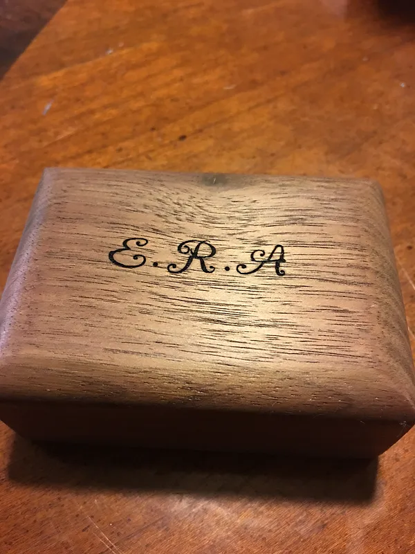

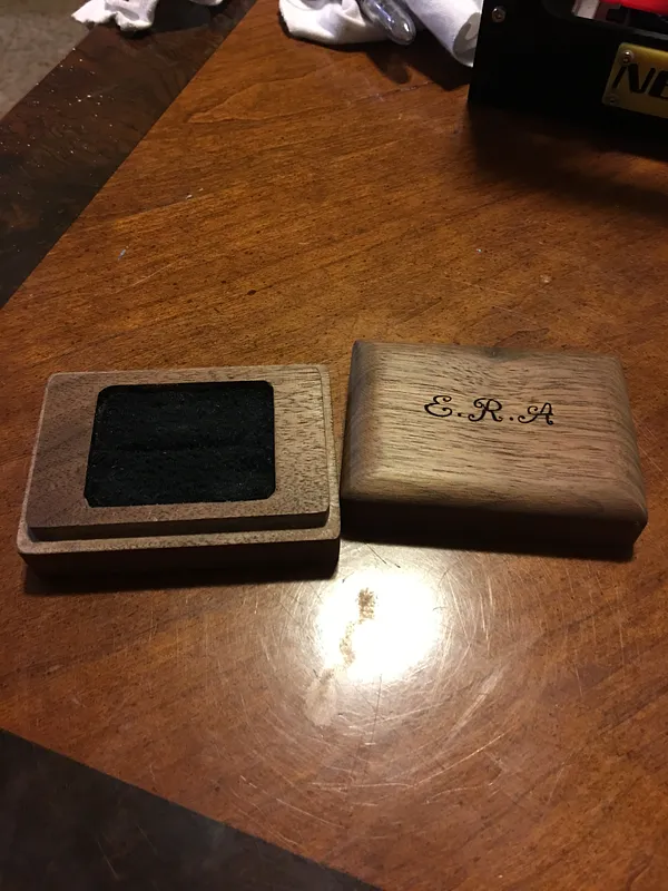

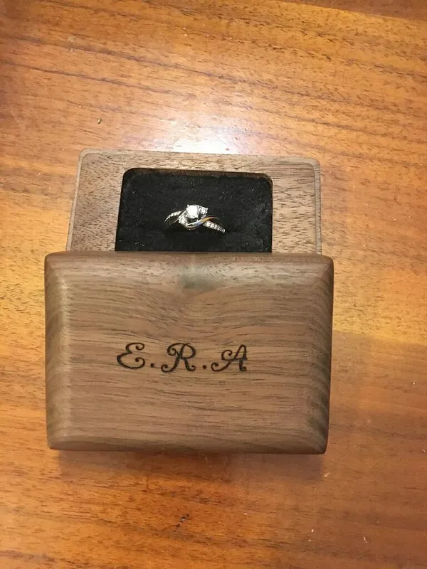

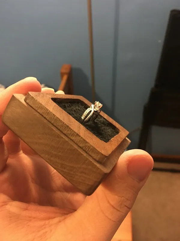

This was a great project, I took your Joe Whittakers plans and shortened them up to make a more common size ring box, I then used a 3/8" round over router bit on the lid to give it a nice curve, and then engraved initials in the top with a small laser engraver.
x-carve 2016
Birch Plywood, Walnut
