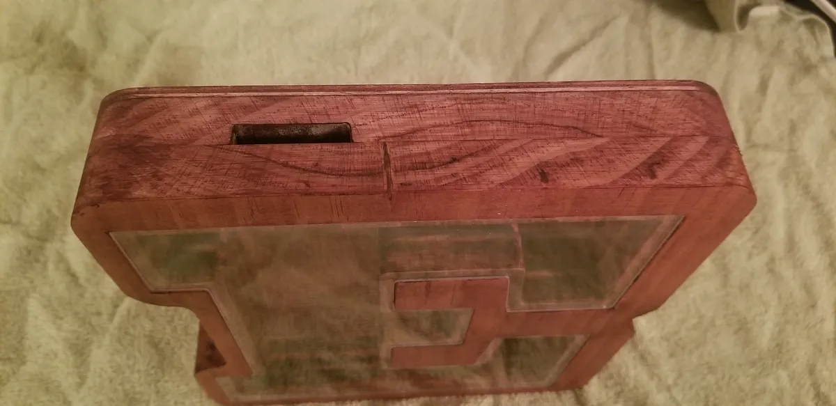

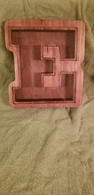

This is 9.5 inches tall and is 3 layers glued together. Bottom is 1/8 Luan, middle and top is 3/4 premium pine. and the acrylic is 1/8 I bought off Amazon. I made the coin slot to be in the middle of the bank, the glueup is simple.

hi im new to cnc i like this design and trying to work out settings etc to do a letter D and a letter O

Shaun Watch a Video on You tube by Paw Paw he explains how to do the letters, I just re done mine to allow a piece to be glued on the back instead of hollowing out all that wood!

thats what i want to do lol trying to work out how you got rebate bit on front for perspex to sit on

I made a D so you can see how the different layers were created be sure to pay attention to on cut and outside cuts! inventables.com/projects/letter-bank-d
