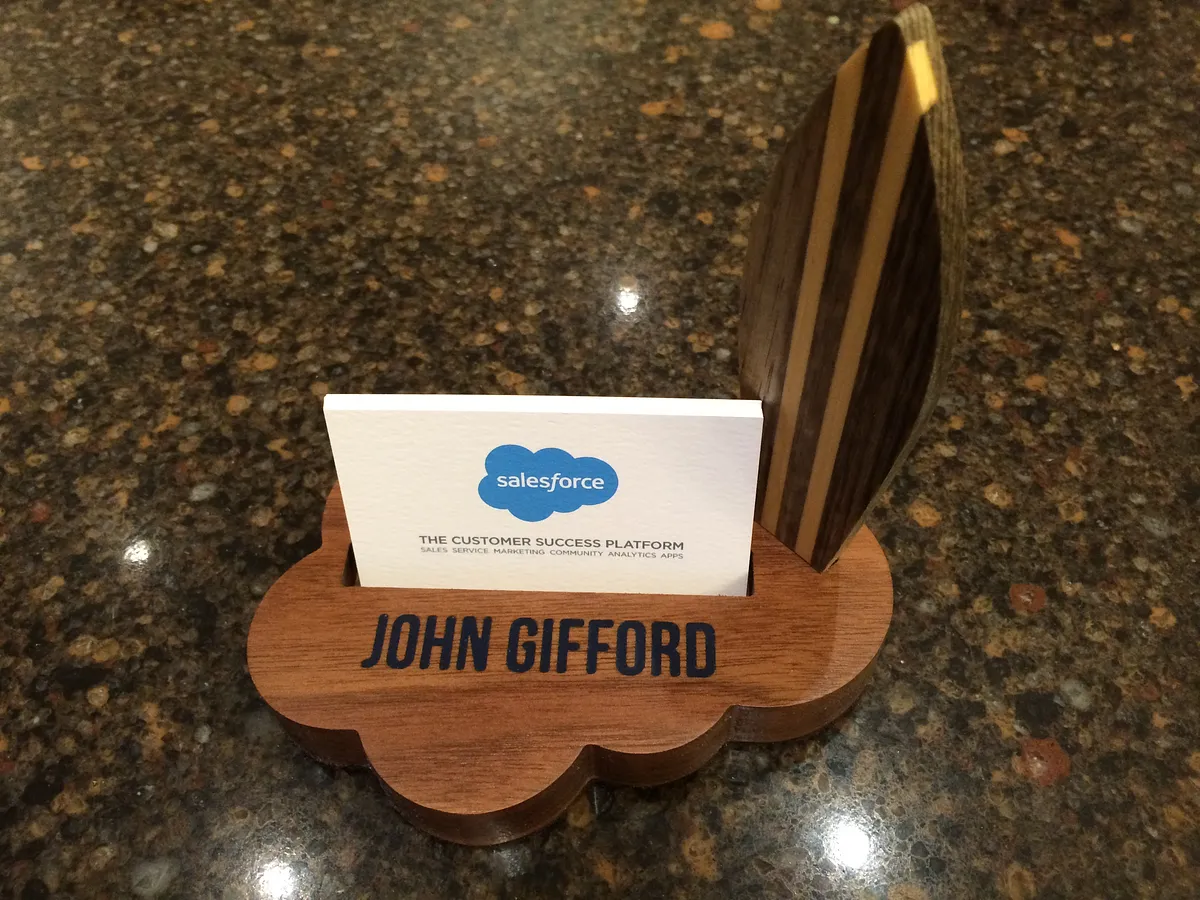

IMPORTANT NOTE: I suggesting copying and pasting the surfboard into a new Easel project and cutting is separately if you wanna remake this. The surfboard was cut from a 1/4" this piece of blue pine and the base from 3/4" Walnut. The machine and material settings in this Easel project are for the base!
Cut out the base
This is pretty straightforward. Setup your x-carve, fasten your wood and get carving. I will note that I carved out the letters first with a 1/16" bit and then the rest of the base and recesses with a 1/8" bit.

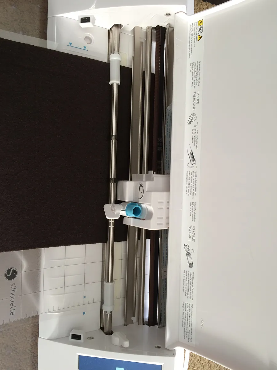

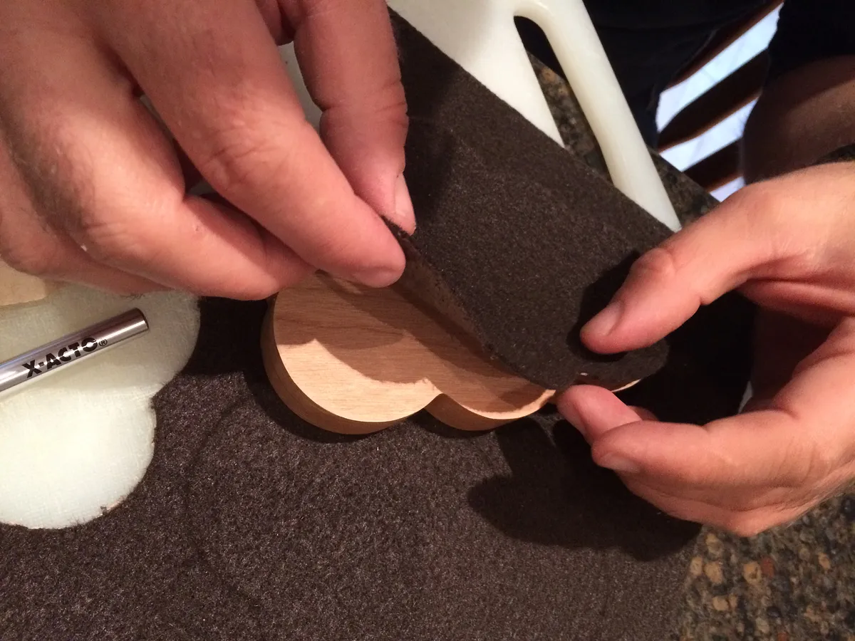

I added felt to the bottom of the base. I cut it out using a Silhouette machine and applied with adhesive.
Assemble the surfboard. You may have to shave the corners of the bottom insert and scrap away any lacquer build up.
