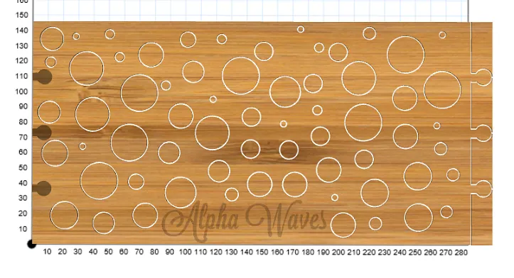

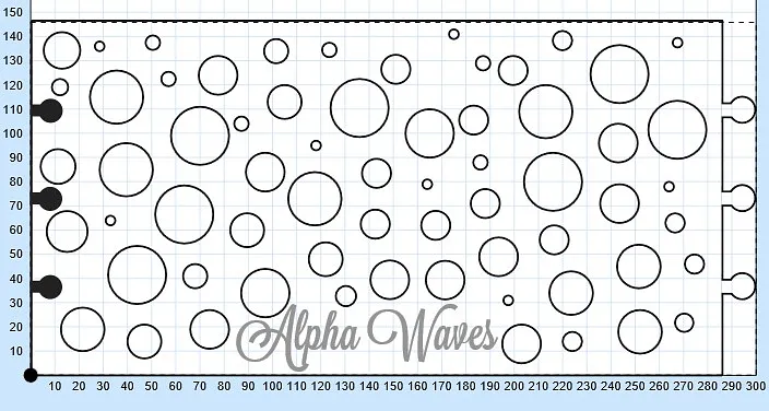

1
Carve Case
Carve the case from Easel
Estimated time: 35 minutes

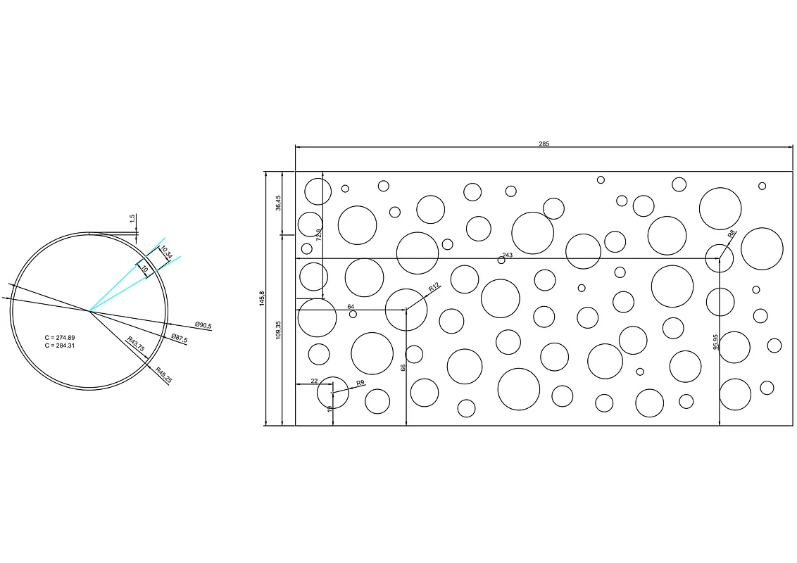

2
Bending
Carefully bend the case into a cylinder, the bamboo may need to be steamed to allow the wood to bend.
3
Connect tabs
Connect the male and female tabs with wood glue to hold the unit together
Estimated time: 2 minutes
