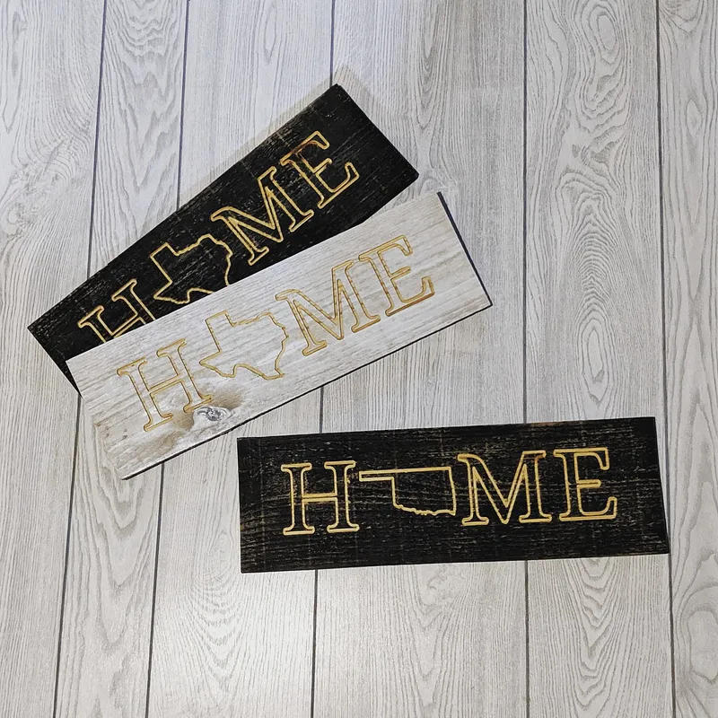

Home state signs, currently with Ohio, Oklahoma, and Texas. Made on an 18" long piece from picket fence, painted and lightly sanded prior to engraving with an 1/8" end mill. If you need a new state, make a copy of the work piece and replace the state with one you would like.

Where did you get the state, I have some but they don't look as good as the ones you have.
Roger · June 23, 2019
I Google "[State] silhouette" then use Easel's image trace to get a smooth vector. If you can't find a good one, try adding SVG to the search
