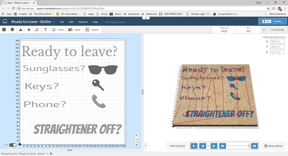

Once you have your material, fire up your X-Carve and get going. For step 1, insert your 6mm MDF, run at the recommended settings using a 60 degree V-bit.
This should take around 30 min.
