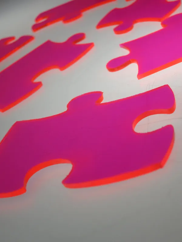

First chose the color of acrylic that you want for the puzzle. I chose pink fluorescent that was glossy on both sides. This makes the puzzle harder because the pieces can be oriented from either side. To make the puzzle easier you can chose a piece that has a matte finish on one side.

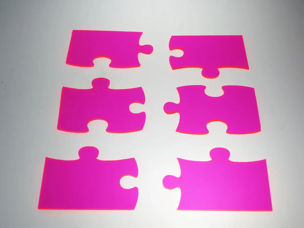

3D carve the acrylic
In the video I used Red on White acrylic sheets. I did the project a second time where I used Carvey and put the fluorescent acrylic in the machine. Each material gives a bit of a different look and feel.

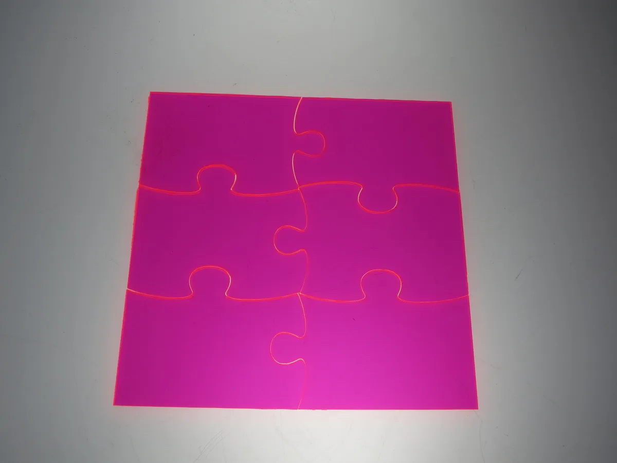

Do you have advice about when and when not to use double stick tape to secure the piece on a thru cut?
Brad Sturgeon · July 14, 2016
I like to use it with materials 1/8" or thinner and any time clamps won't be able to hold the piece as parts are cut out. Puzzles are a great example. I like to pause Carvey as each puzzle piece is finished and take them out to avoid them coming loose and damaging other parts.
