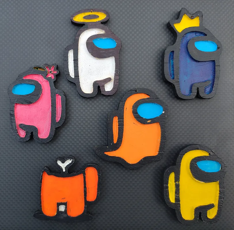

Carve side with outlines.
Switch back to the 1/8" bit if you haven't done so yet and rough out the stock. Switch to the 1/16" and cut the details. After the internal details are cut, the 1/16" bit is used to cut out the outline of the pieces to release them from the stock.
Estimated time: 10 minutes
Sand edges.
The edges will likely be a bit rough, nothing that a quick pass with 150-220 sand paper won't fix.

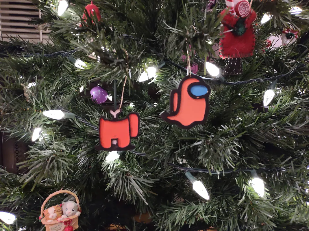

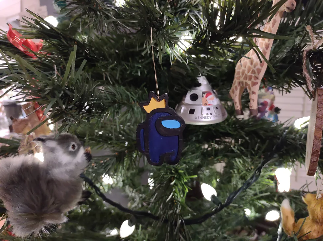

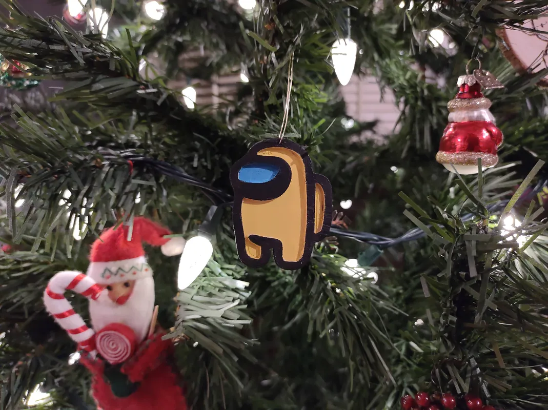

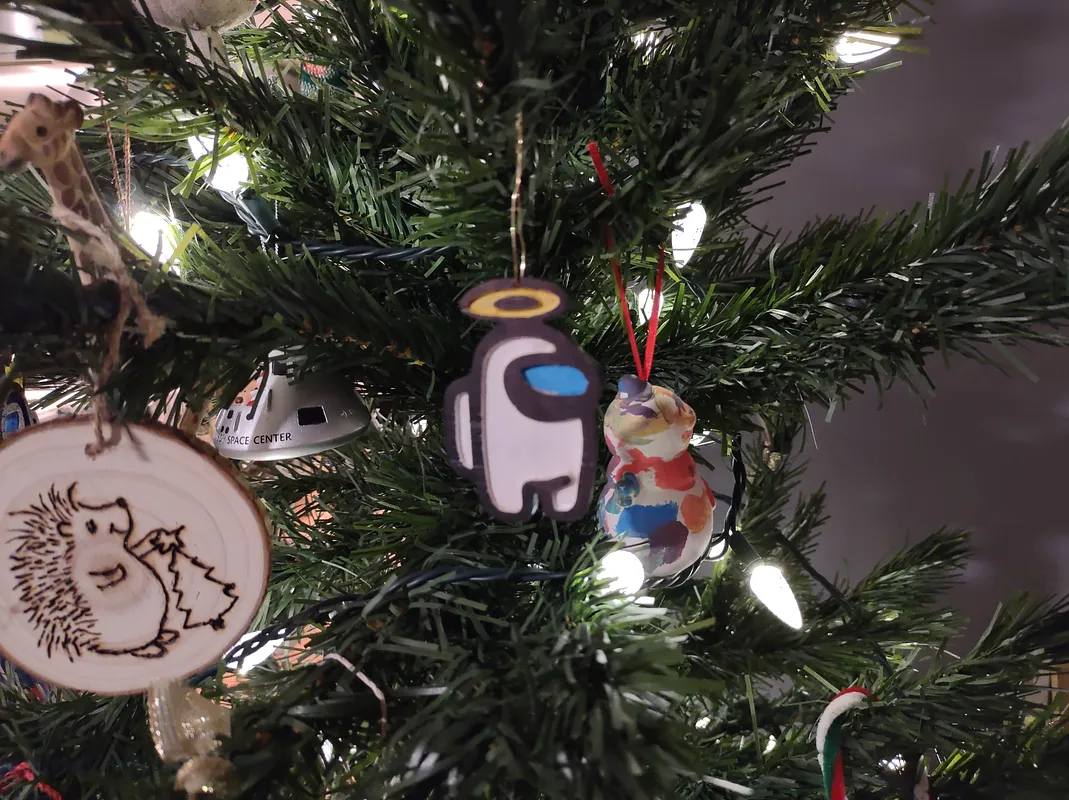

Paint.
Finish them up with a bit of paint to make them look as you desire. Then find a hanging material. We used 24 gauge brass wire, but paper clips, thin yarn, string or other similar material can be used to complete this step.
