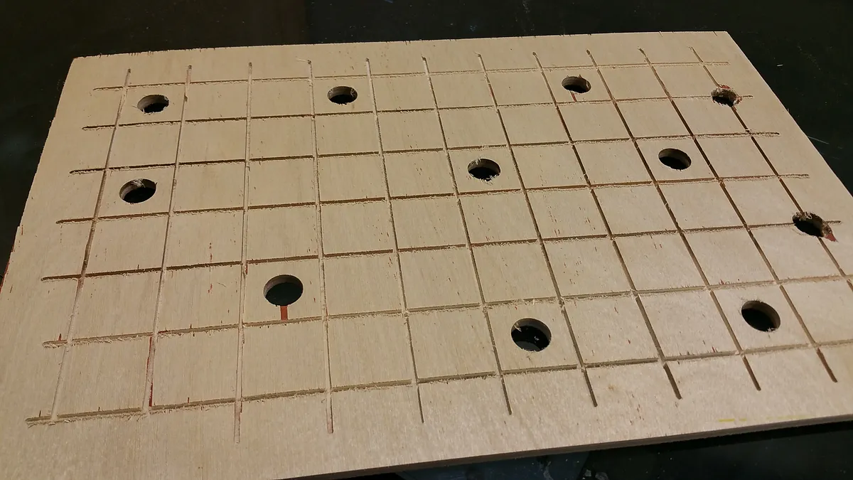

A simple design to fit over the existing spoil board that's fastened to the machine itself.
An 1/8" board, cut to 8"x12", should allow you to do full depth cuts on different projects, without cutting into the existing spoil board. Install it when you need it. Remove it when you don't!
