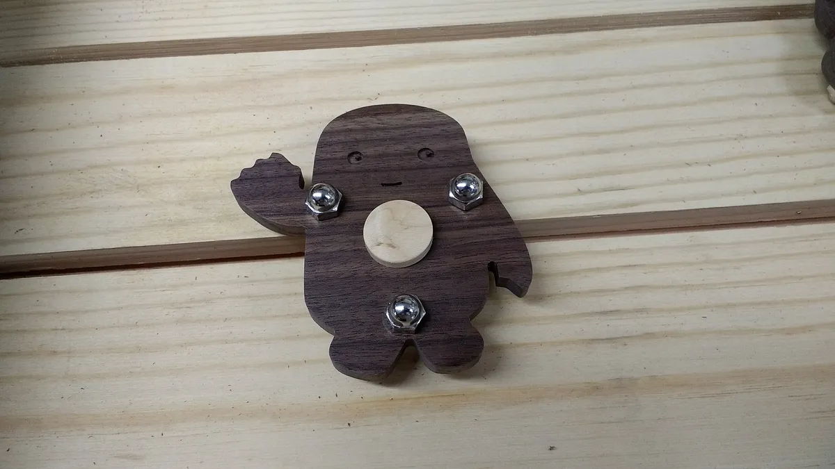

One copy will be for the face, which is cut with a 1/32 in. mill. Delete the body and the holes. Cut this first.
The other copy is for the outline, which is cut with a 1/8 in. mill. Delete the face. The three 1/4 in. hole around the outside are for threaded rod and cap nut weights. I am not sure if I would use these as weight if I did this again. They are a little too bulky. I would try something a little more low profile. Set the material thickness to your thickness. Cut this second.
