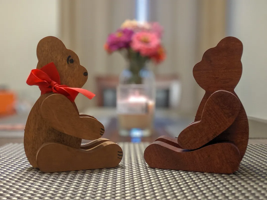

When designing this, I used some 4/4 mahogany, but you can use whatever kind of hardwood at whatever thickness you want. This bear is held together by 1/4" oak dowels. In the easel project you'll notice that I have holes drilled, but these just serve as pilot holes so you can use whatever size dowel you have.
For mine, I wanted to recreate what they had already made, so the dowels are hidden. To save a little time though, you could just run dowels all the way through all three tiers and leave them exposed. I'm sure that will look fine. When assembling, just be sure to make things pretty tight and make sure everything lines up, that way you can "pose" the arms/legs and the bear sits level.
