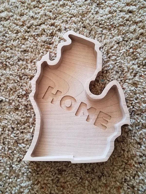

Here's a neat gift idea for all you Michiganders!
Start on the first page, route out with a 1/4 inch cutter.
Flip to page/part 2. Here's where it takes some specific direction- 1st, you'll need to change cutter sizes from the 1/4 inch to the 1/8 inch straight cutter. DO NOT MOVE YOUR MATERIAL OR YOUR X/Y AXIS!!!
Go into "Machine" and change the advanced settings for the safety height from 0.15 inches to 1 inch.
Click Carve, reset your Z axis flush with your material. Before sending, manually lift your router Z axis 0.1 inch. Turn the router on. Now in 0.1 inch increments, drop your Z axis 7 times. This will drill a hole into your material. Then drop your router .01 inch 3 more times. This will give you a hole depth of 0.63, which is almost exactly the same depth as the dish inside.
Shut the router off. Leave the router in the hole. Set that as your home Z axis. Send it. The router should lift 1 inch and clear the side walls.
This method will save about 20 minutes worth of "air cutting".
Move on to page 3. Make sure your Z axis is left at .15 inches for the lift (default). Carve away!
I hope you enjoy this dish as much as I do and as much as my customers do! Good luck!
