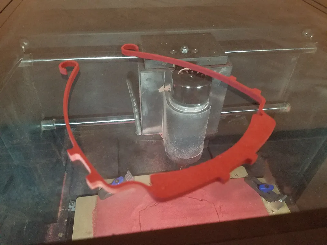

On my Carvey with a 1/16" bit this took 11 minutes.
Estimated time: 11 minutes

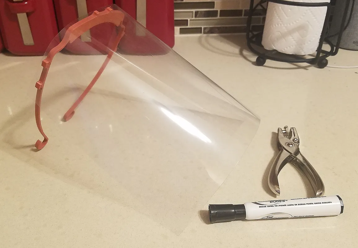

Use a hole punch to make holes for a letter-sized plastic sheet
I used a dry erase marker to mark the spots on a plastic report cover where I should use a hole punch to make holes for the rectangular grips to push through on the visor.
Estimated time: 3 minutes
Press plastic sheet onto grips
Press the plastic sheet onto each of the rectangular grips, forcing them through the holes created with your hole punch.
Estimated time: 2 minutes

Hi. Exactly which bit did you use?
Tommy Klausen · April 01, 2020
I used a 1/8" upcut bit to cut these. I did one with a 1/16" and found the visor to be quite brittle.
Kevin Loeffler · April 02, 2020
What material did you use? I looked in Easel and it shows MDF. I am considering using expanded PVC.
PAUL BESSERPro · April 05, 2020
I used MDF, but I'm sure expanded PVC would work great! I've also made a few out of plywood, which seems to work nicely as well.
