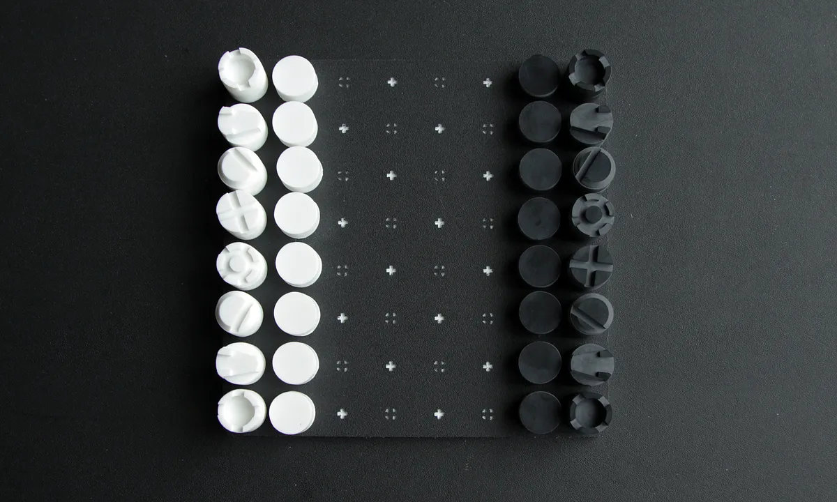

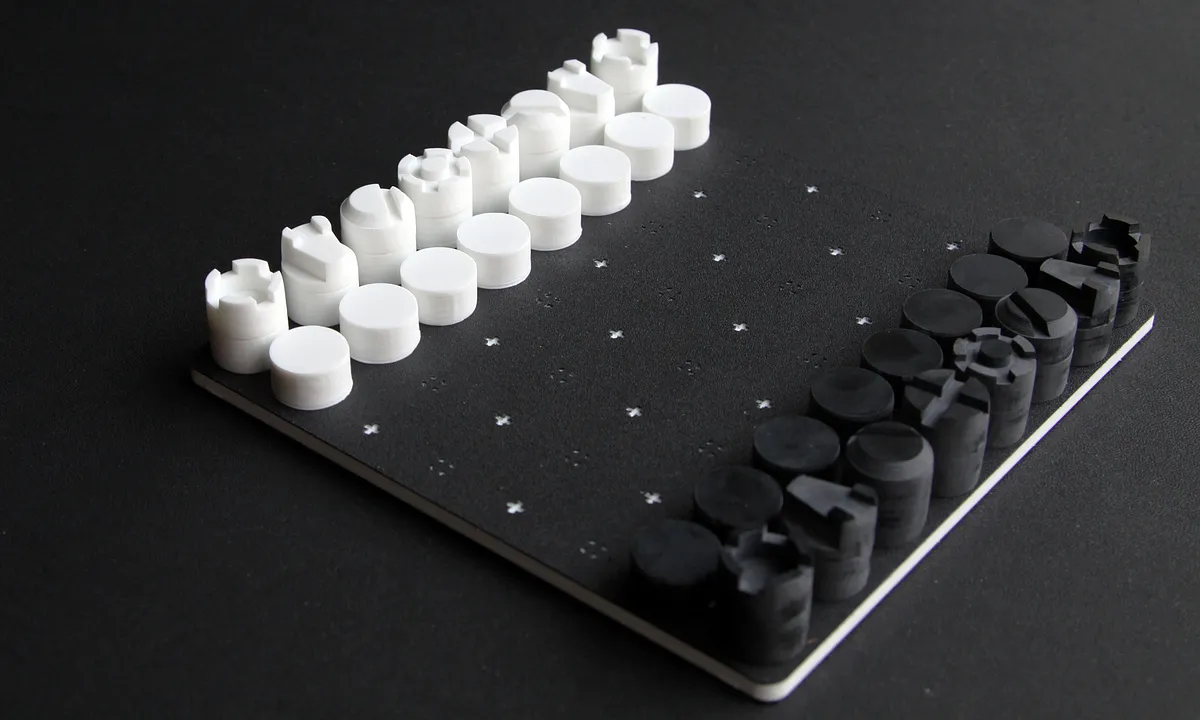

Mill White Corian Pieces
Mill your first set of chess pieces from 1/2" material
Use this EASEL "link":http://easel.inventables.com/projects/JqezLHQiz6i9UoODgvzQCg
Mill Black Corian Pieces
Mill your second set of chess pieces from 1/2" material

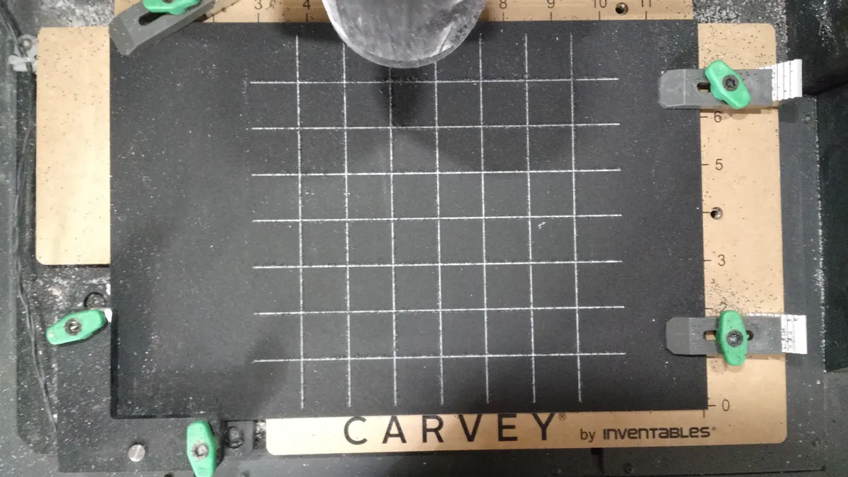

Etch grid into HDPE
Use a 1/32" bit to etch a checkers grid into one side of the HDPE
Use this EASEL "link":http://easel.inventables.com/projects/ZsocJr7mhnGwbxPxeaWqQQ

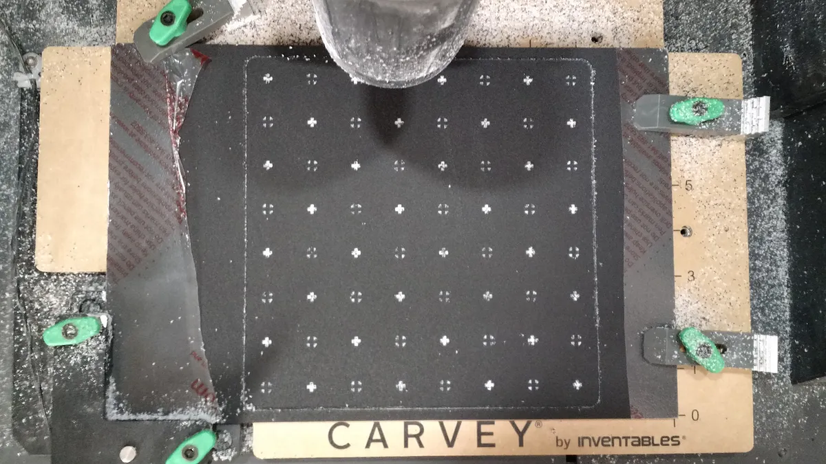

Cut Reverse side of HDPE
flip HDPE sheet, being careful to align it in the correct position. Etch the chess pattern with a 1/32" bit and cut the profile
Use this EASEL "link":http://easel.inventables.com/projects/HAmzJ3iG4b5d8_EEDk28YA

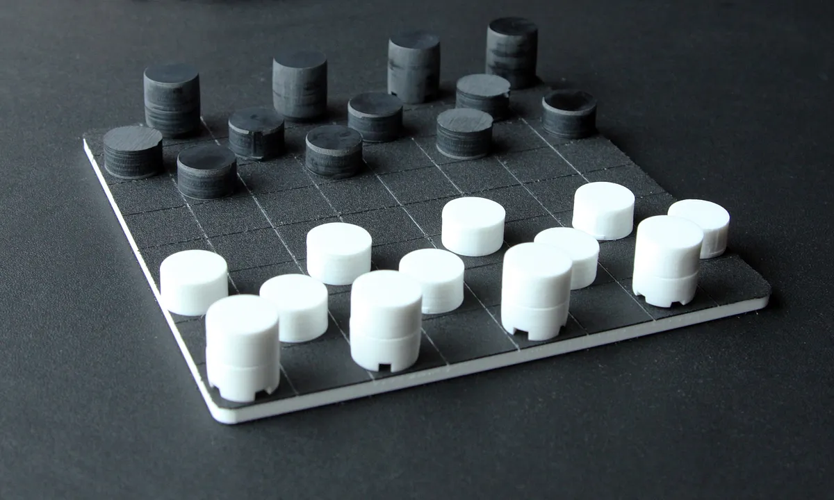

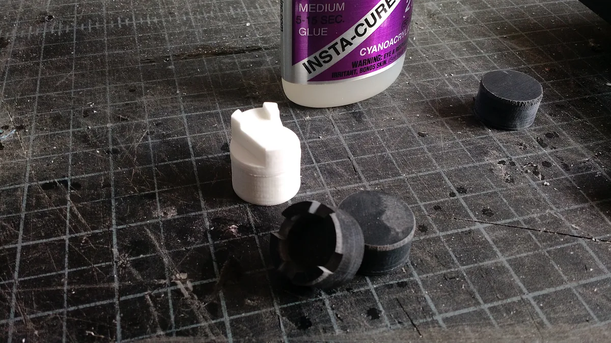

Glue and sand pieces
Glue pieces into stacks to create the taller pieces, leaving single height parts as pawns. Sand the sides smooth once completed

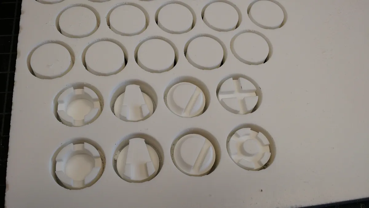

How did you cut out the chess pieces? What was the bit size?
Tyiesha Gainey CraftonPro · March 08, 2018
Thanks for sharing! I modified your designs to make a larger set from cherry and purpleheart. Love it. If I were to do it again I think I would try etching the grid after cutting the profile. Also, I'd recommend to anyone making this to cut the profile with a 1/16" or larger bit, not a 1/32".
