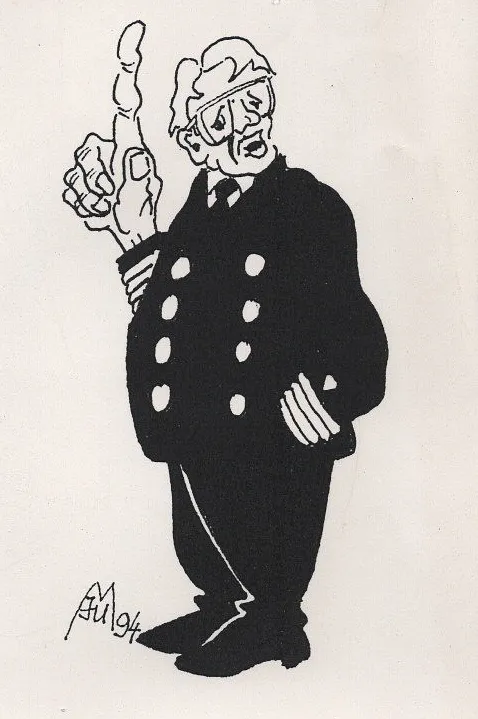

Cut the outside a couple of millimeters
First cut the outside a couple of mm deep to have a sketch to work on.
Estimated time: 10 minutes
Two-three coats of paint
Paint the uniform dark blue, and the area where there is no uniform paint it in a light rose tone. Finish up with two coats of glossy finish.
Estimated time: 120 minutes
Carve the inards 50%
Run a carve with a V bit or similar to half the final depth.
Estimated time: 240 minutes
Rub some gold
Rub gold gel or similar onto the buttons and sleeve stripes and finish up with some coats of glossy finish.
Carve the rest of the inards
Now carve to the full depth.
Cut out the figure
Now using a different bit, cut out the full figure.
Estimated time: 45 minutes
Makeup
Paint the eyes, teeth and glasses, maybe add some blue between the sleeve stripes.
Estimated time: 20 minutes
