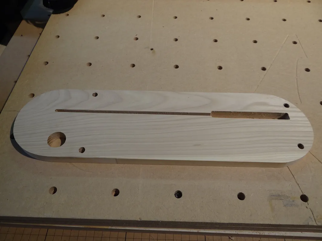

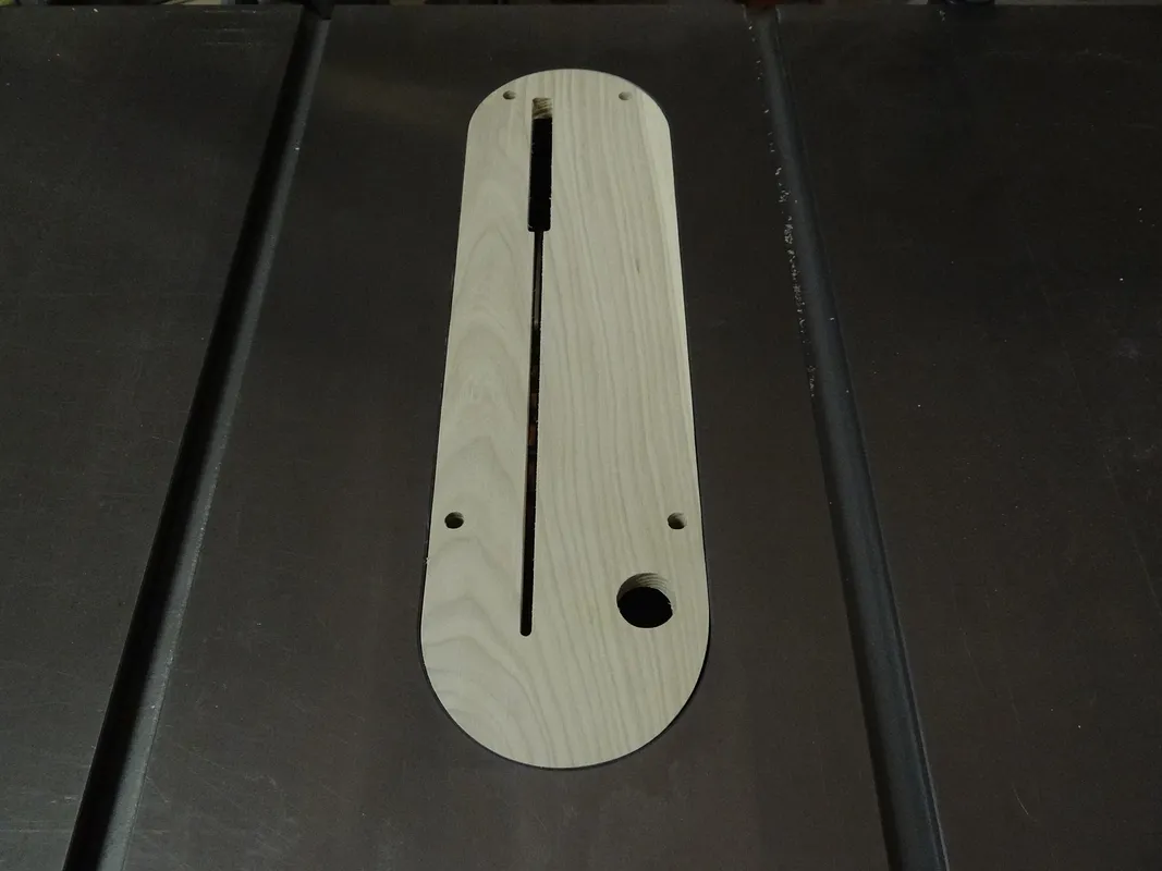

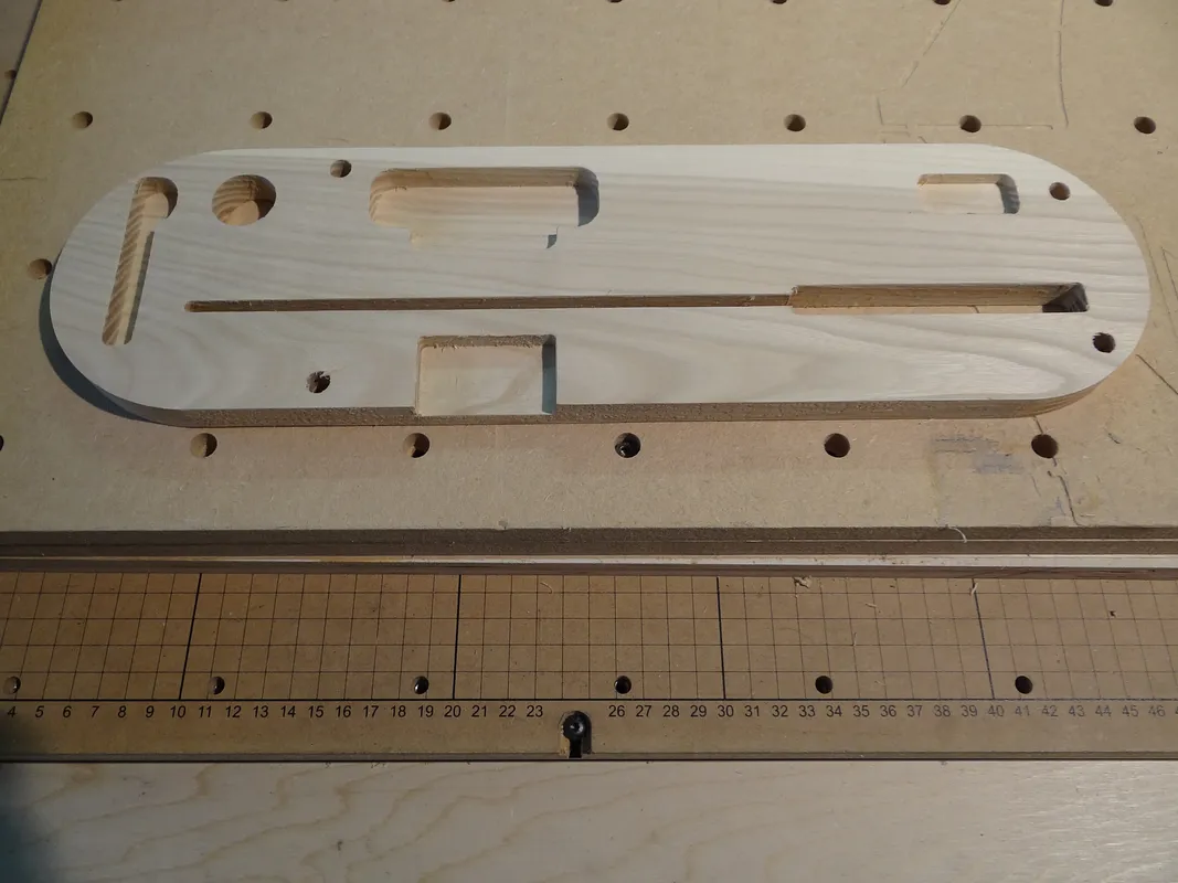

An insert for my SawStop Tablesaw. NOTE: I intentionally made this just a hair too long so that I could sand the ends for a very tight fit. The 4 small holes are for the addition of 1/4-20 insert nuts in case your Insert is not the exact thickness needed.
