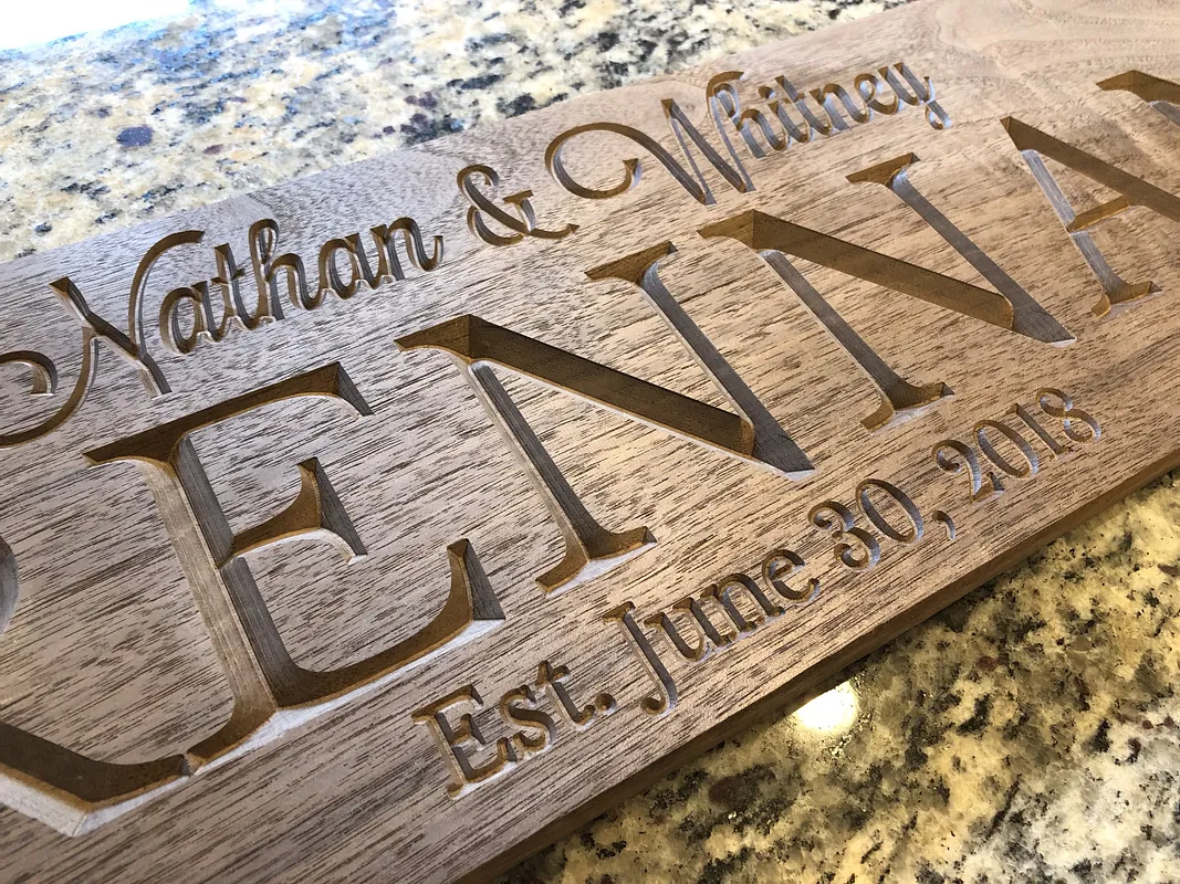

Carve
It is important to carve this design using a v bit so that you can get all the detail. I used a 90 degree one, but you could also get good results using a 60 degree.
Actual carving time was 24 minutes using the recommended settings in Easel.

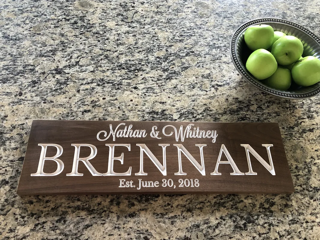

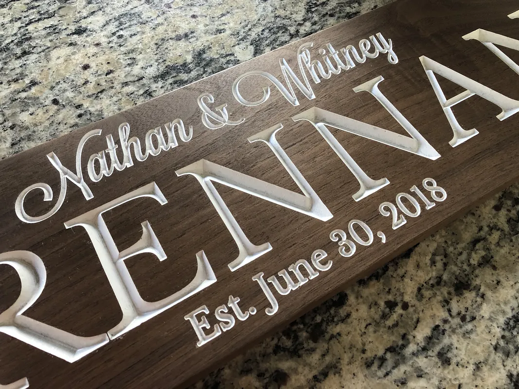

Paint
I use a fine brush to paint on 2 coats of white Rustoleum high gloss protective enamel. This helps the text shine and pop. It gives great contrast with the dark walnut. I let it dry for about 24 hours before sanding.
Estimated time: 10 minutes
Sand
I used a sander with 120 grit sandpaper to sand the front of the workpiece. This gets all the stray paint off the top surface around the letters. The paint will stay inside the letters since it is below the surface. Then I used the sander to round the edges, and smooth all the sides. I repeated it with 220 grit as well to give a smoother surface. Be sure to vacuum or shopvac all the sawdust off afterwards.
