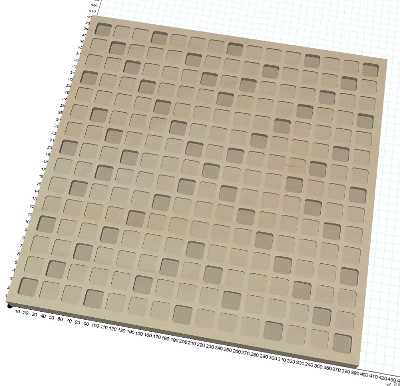

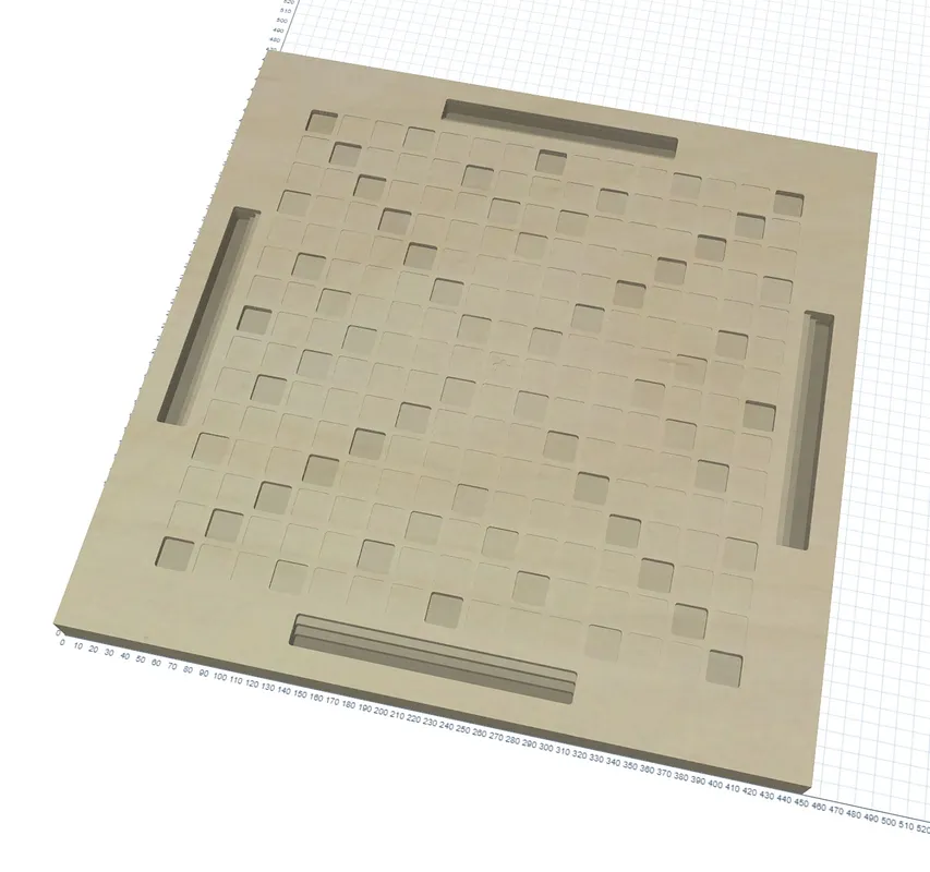

A simple pocket cut scrabble board (with 20mm playing piece pockets). I based this off of the standard playing piece of 19x19mm.
Updated the project (accidentally deleted it) with the addition of the player trays, easily be removed if not needed.
Adjust the piece depths to suit your pieces
I set the "bonus" squares to be 6mm deep, so they are clearly visible when using my project, but also because if I were making this, I would inset a different colour wood to highlight the squares. Given that original pieces are 4mm thick, I would aim to have the finished pockets at about 1.5mm.

Accidentally deleted it. Shared a slightly revised version.
