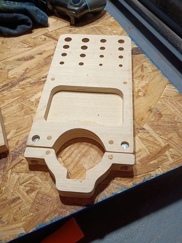

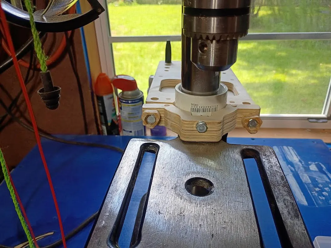

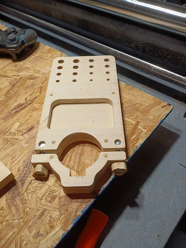

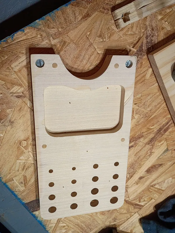

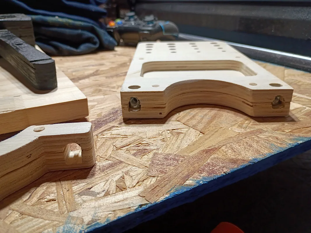

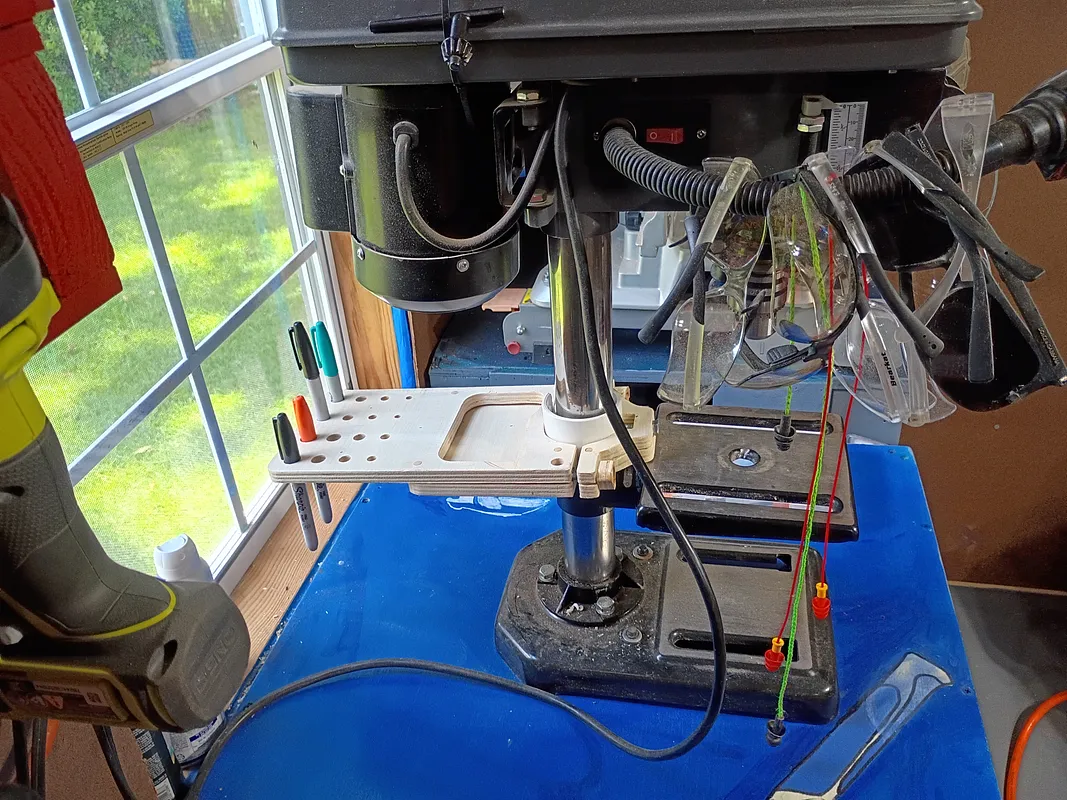

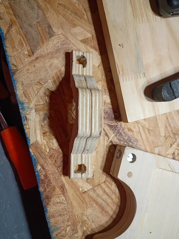

Ok, I was a little wide on throat for the harbor freight drill press so i had to get a 2 inch pvc coupling split it to put this on. I also used 1/4 tap and drill into cylinder for better holding power.
