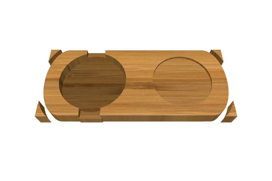

you'll want a piece of stock at least an inch thick. first you'll route out step one using a bowl and tray bit, then you'll run step two with a 1/4 bit to profile the coaster and cut the tray out.
