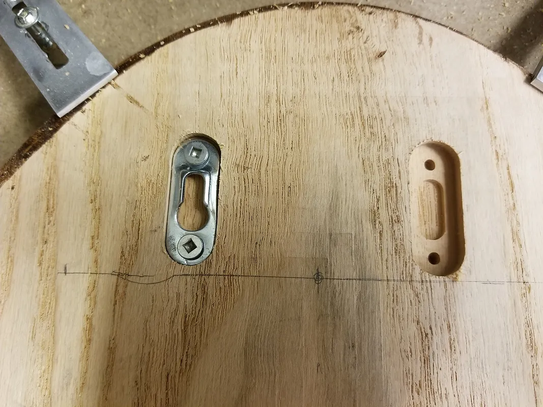

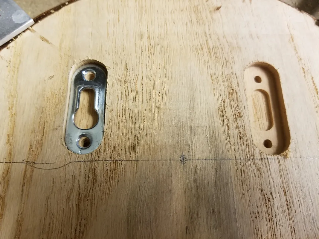

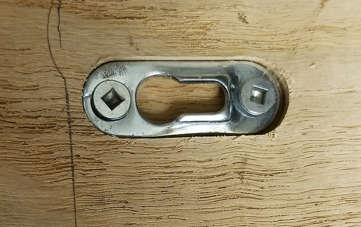

A project to make mortises for keyhole hangers you can get at home depot.

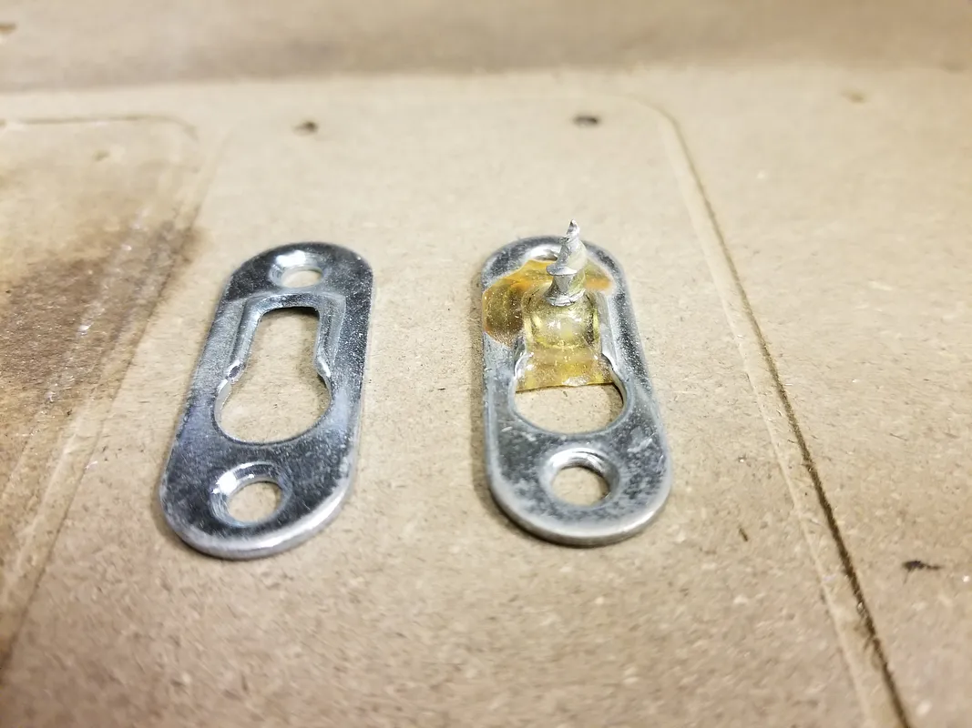

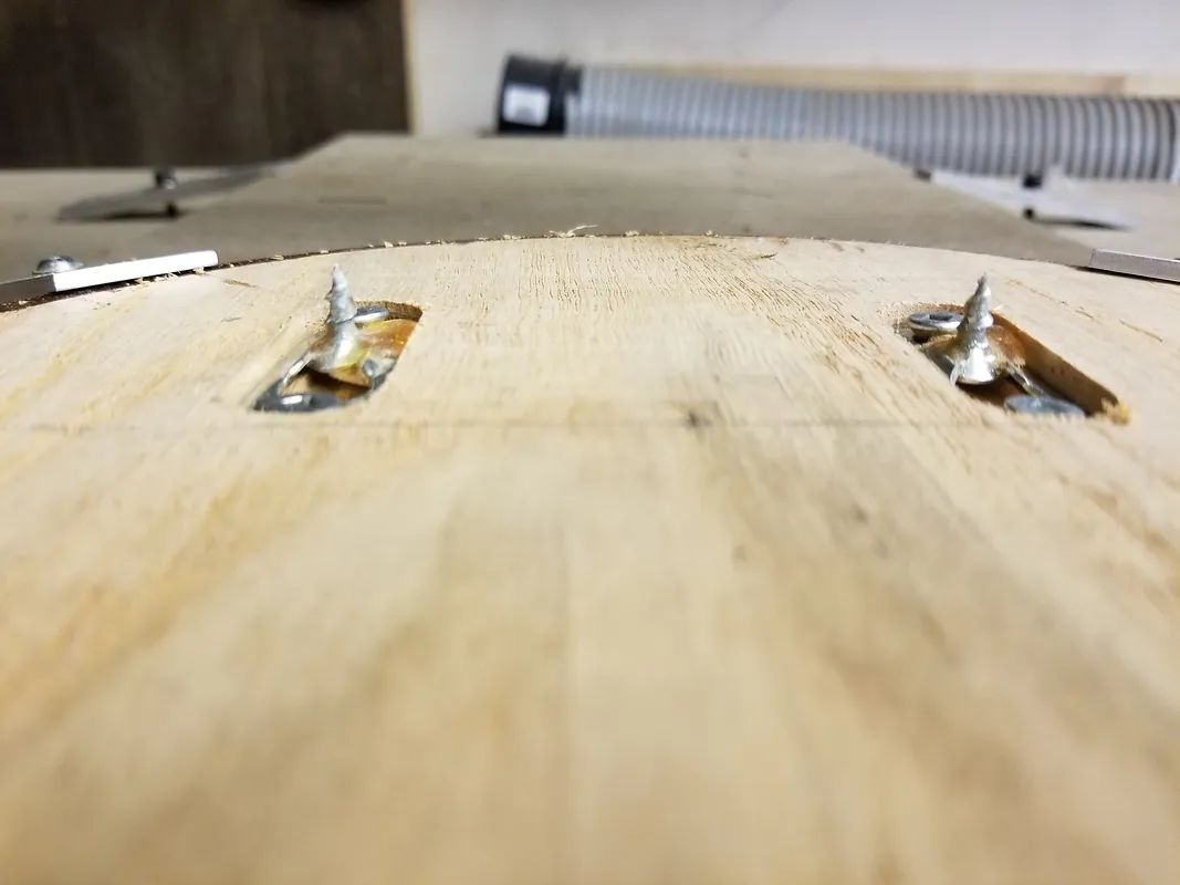

To align a project on the wall, I epoxy short screws onto spare hangers, then I use those points to make a mark on the wall where the hanging screws will go.
