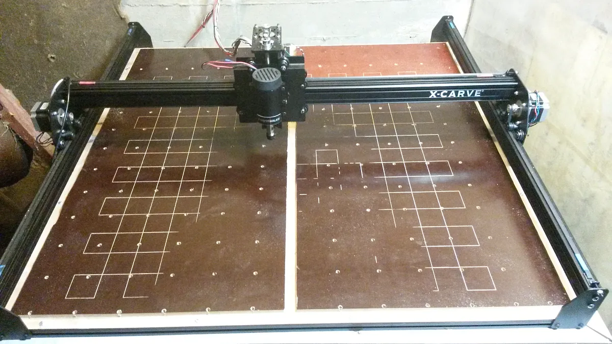

Wasteboard engraving 5cm2
To engrave a 5cm grid onto your wasteboard.
Usefull for the ones that diy their own. Use the smallest bit that followed in the geting started. Or a V-bit
Depth is set at 1.5mm, i did run it with 0.5mm and i discovered some sagging on my board.
