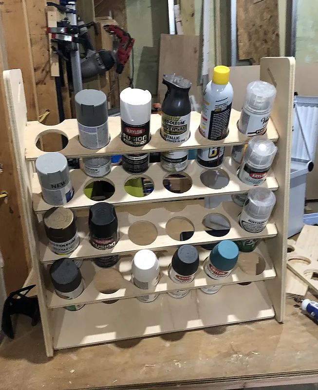

aresol/spray paint rack made out of .5'/12mm plywood entire project takes 24"x48" piece i got the file from a FB group didn't like it so designed this one its not a stolen file its free to you and as i tweak it i will update this file as i know its not perfect the back slots are for 1x4 bracing
X-Carve
picture is the only one i had on hand not finished product and just happened to be from when i was test fitting wasnt

I really like this idea. Just a question for you, did you cut it out using the cut settings in the custom settings, if so did you have trouble with bits breaking and what brand of bit did you use?

i believe they were hq master compression bits I didn't have any trouble with bits breaking while running custom settings

HQ Master Compression Bits. Best and fast for ply.

How does this attach to the wall? I see the grooves cut in the back, but curious if they're functional

it was intend for 1x stock to brace it and hang it on the wall

I see you say 24"x 28" of plywood .5" how many pieces of wood i see 4 cuts
