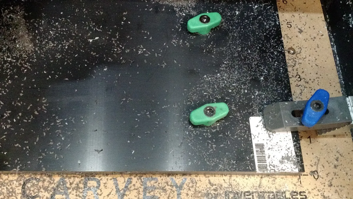

2
Cut Flip Mill Holes
Cut registration holes for flip milling the corian base. Make sure your piece is 6" tall and between 10" to 12" wide.
Use this EASEL "link":http://easel.inventables.com/projects/MuH9T9oqbI_gqvv6bSR1Wg
Candle Holder — Cut Flip Mill Holes

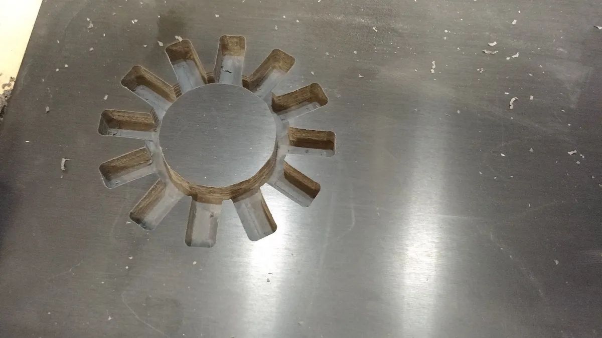

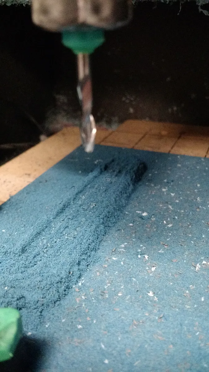

Mill Top Features
For this cut use a square or fishtail 1/8" endmill.
Use this EASEL "link":http://easel.inventables.com/projects/DPqVRKwWqUvVokiun5KpfA
Candle Holder — Mill Top Features

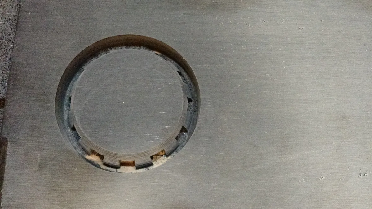

4
Flip and Mill Chamfer
Flip the part over, using the registration holes as guidance. Mill the Chamfer onto the base, which will also cut the parts profile.
Use this EASEL "link":http://easel.inventables.com/projects/wWXpAHwaRLSzfHxWWXZWcg
Candle Holder — Flip and Mill Chamfer

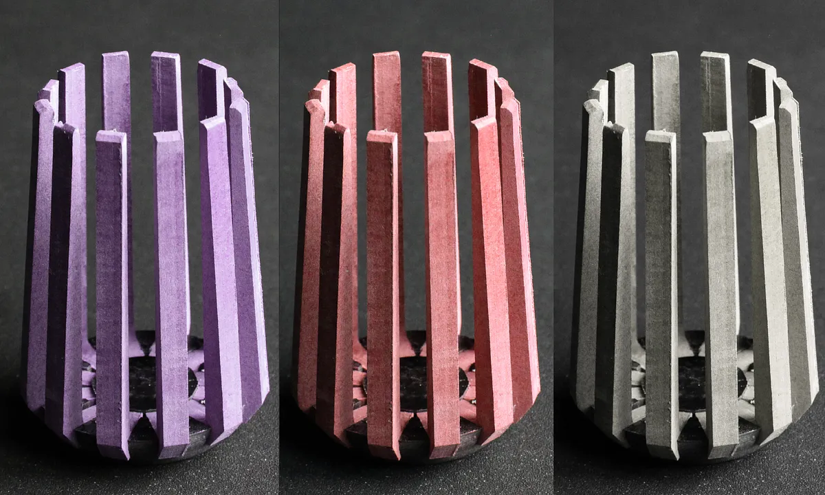

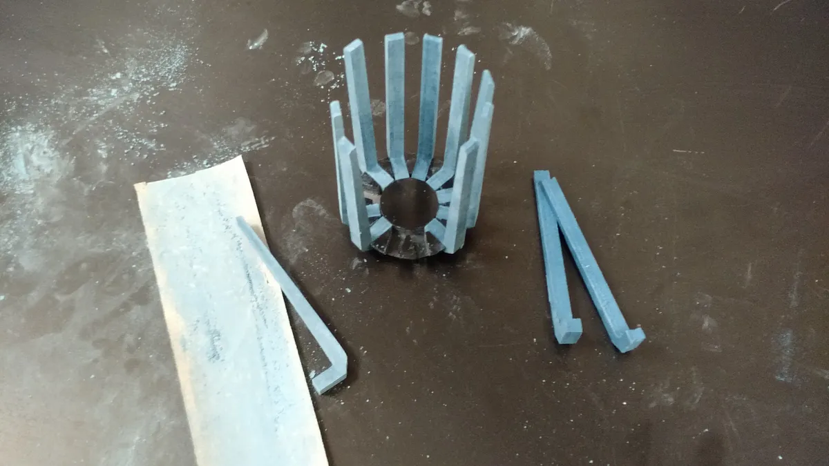

Fit and Finish
The wall sections may require light sanding for a proper fit. You want these to fit, but be tight enough to stay in place without glue.
Candle Holder — Fit and Finish
