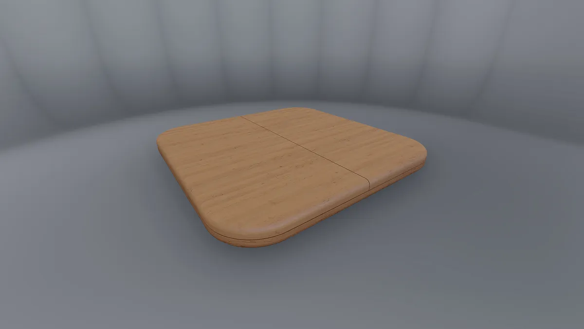

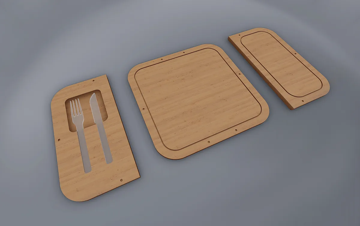

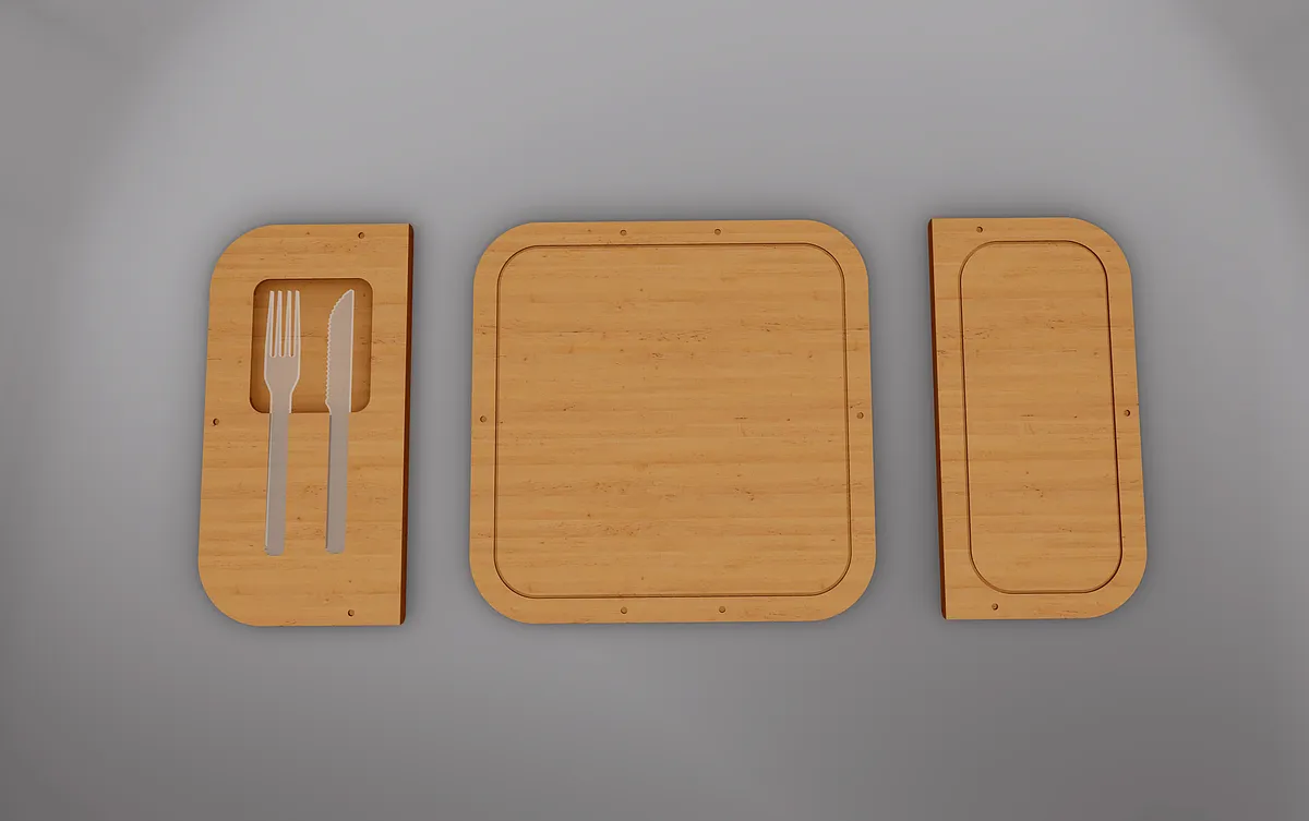

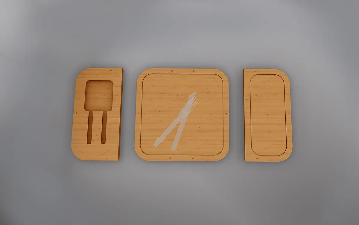

Material
For this project you will need to following materials: - 12 x 12 inch 3/8 inch Bamboo Plywood - 8 x 8 inch 1/4 inch Clear Acrylic Sheet - (12) 4 mm wide 2 mm deep rare earth magnets - 150 grit sandpaper
Estimated time: 5 minutes
Carving
Set and fasten your pieces and carve them. This should take about 55 mins without taking material change into consideration.
Estimated time: 55 minutes
Chamfer Edges (Optional)
If you have a router with a roundover bit, rounder over the edges with curves on the bottom side of the plates.
Sanding
Sand all the edges down with your sandpaper until they're nice and smooth.
Finish
Dip the bamboo plywood in mineral oil for a food safe finish.
