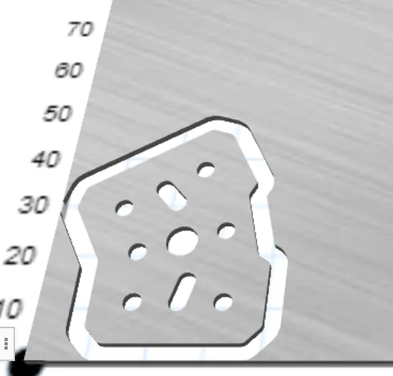

Carve aluminum
Carve the aluminum using the Easel project.
Notes: - Use lubricant/cooling to extend the life of the bit - Use a brush or compressed air to remove the chips to improve finish and extend the life of the bit
Estimated time: 5 minutes
