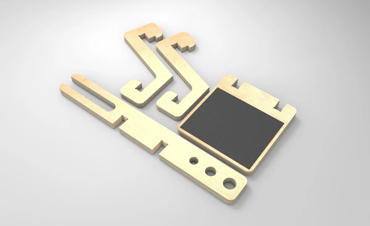

This design can be easily cut with little to no post processing and finishing and takes about 47 mins on the x-carve.
Estimated time: 47 minutes
Assembly

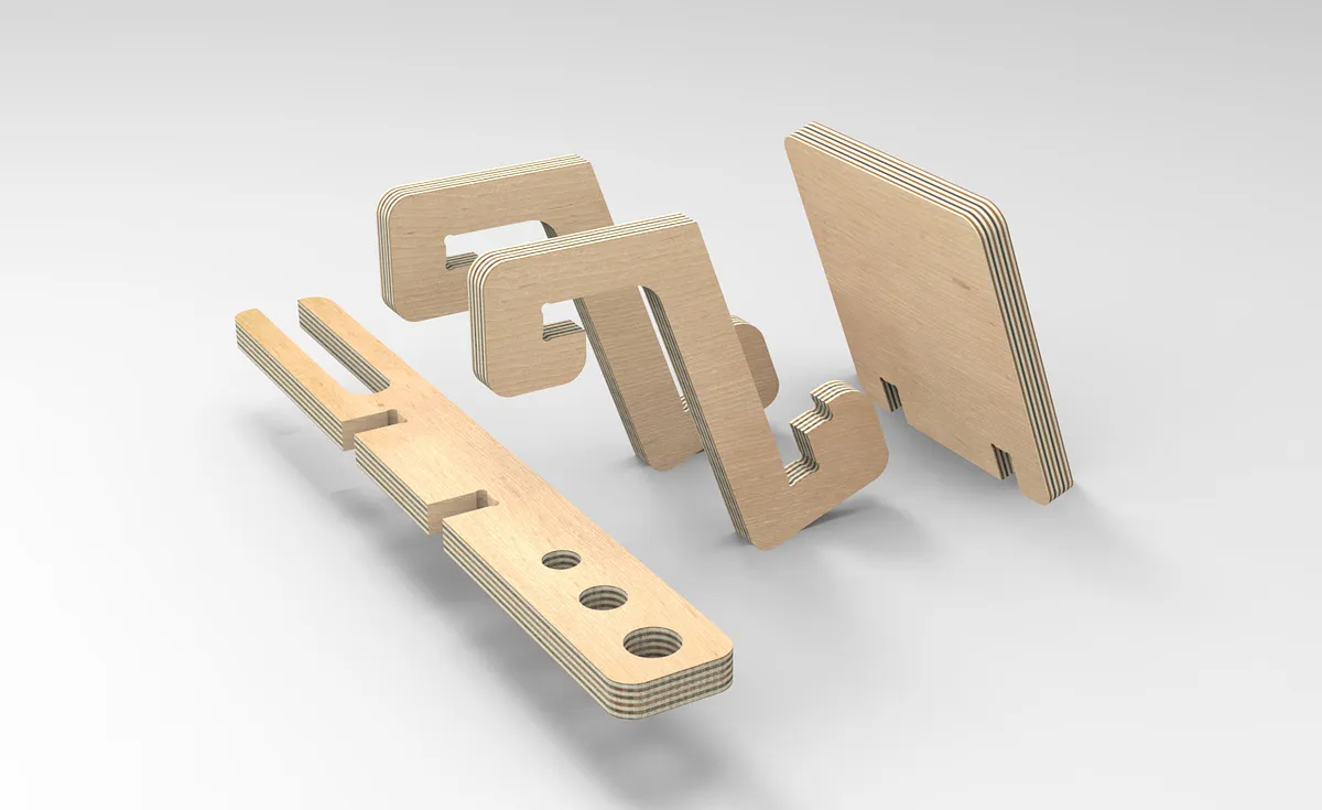

Once cut on the x-carve, the mount is easily assembled by means of a slotting system. A section of micro suction tape is then adhered to the large rectangular back plate surface.
Estimated time: 1 minutes

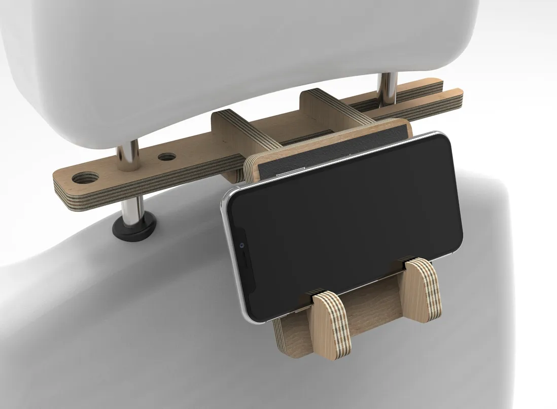

To install, first the headrest is removed. The left headrest post is positioned in one of the three different sized holes on the left of the mount. The right post is located in the slot on the right of the mount. The headrest posts are then re-positioned in the seat.
This configuration of slots and holes allows the headrest mount to be attached to a huge variety of headrests, with post diameters ranging from 10-14mm.
Mount a device

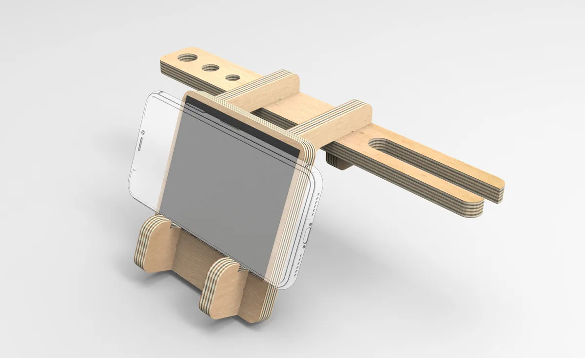

To mount your tablet or phone, simple press the device firmly against the micro-suction tape on the back plate.
Once installed, the device bracket can be detached from the headrest rail mount. This feature gives the user the ability to store the extending portion of the mount without having to first remove the headrest.
