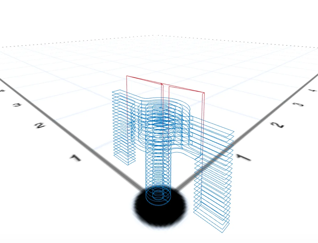

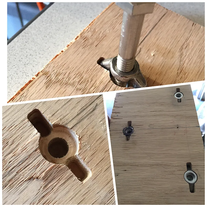

wing nut mount incision
Incision cut for a standard 3/8" steel wing nuts so these can be embedded in 0.725" thin plywood (wing nuts are 0.61" height). If your piece is thicker, you have to adjust the depth of the cut of the hole that goes through (the center one) the plywood
