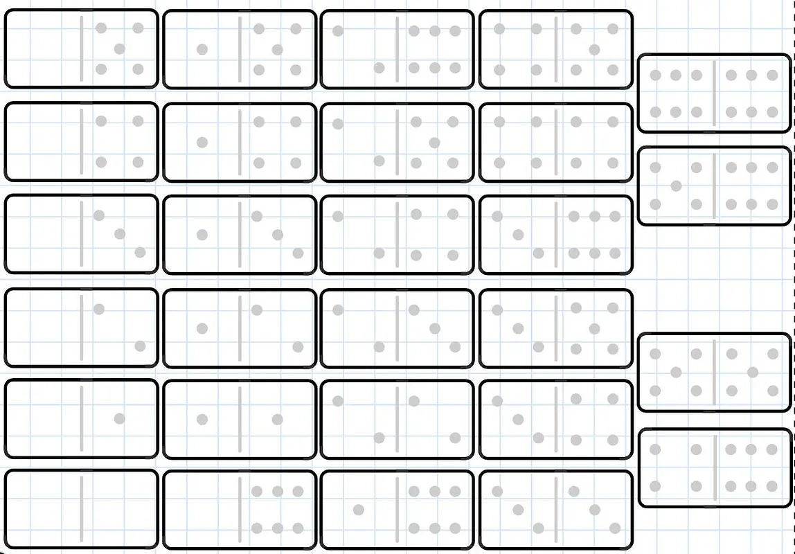

Simple Dominoes. Cut from 203mmx254mmx6mm(8"x10"x1/4") MDF. 1mm straightcut bit. 3 tabs per cutout, or if use the painters tape super glue method you can remove the tabs. Paint the MDF first for an interesting look or paint after and sand off to color the pip pockets.

Wait...Is this just half of a set of Dominoes?
