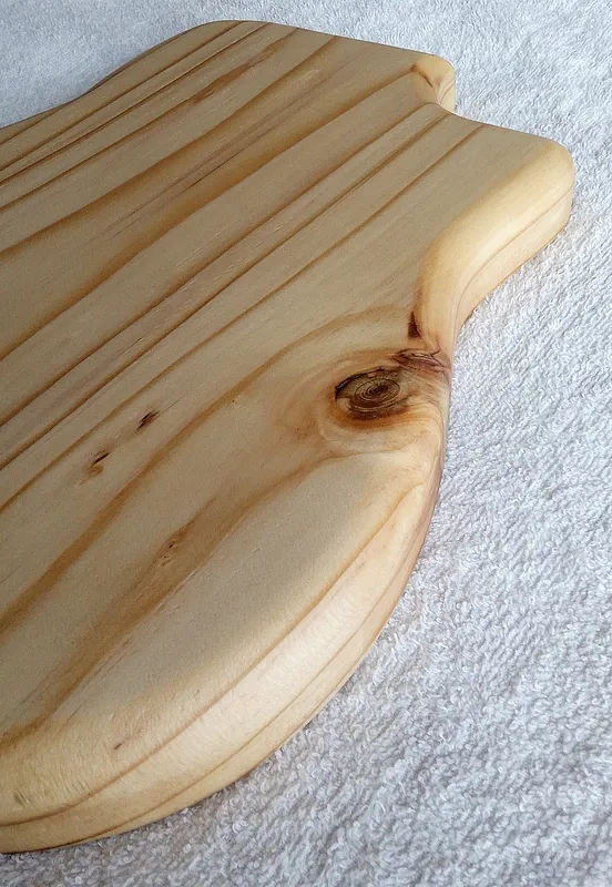

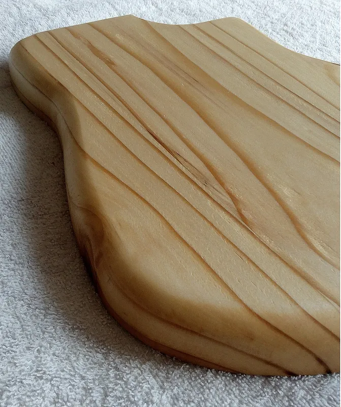

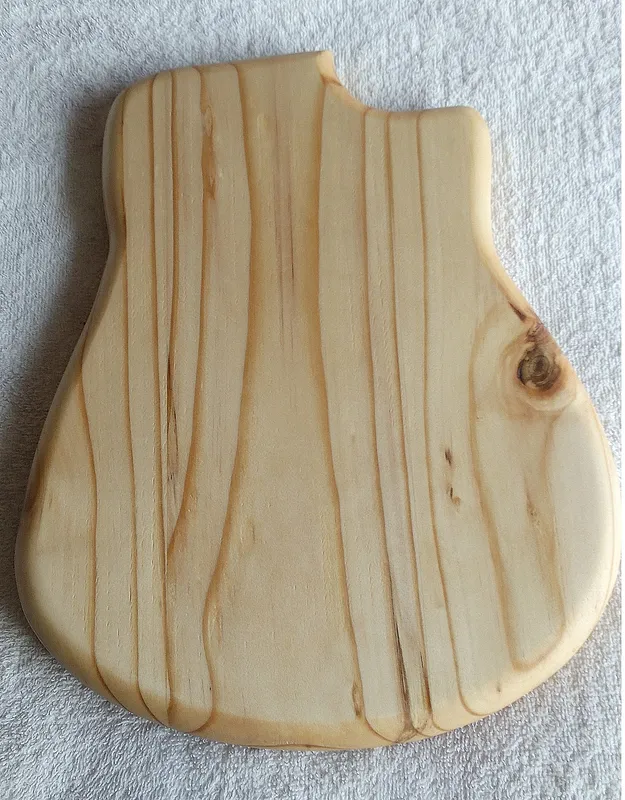

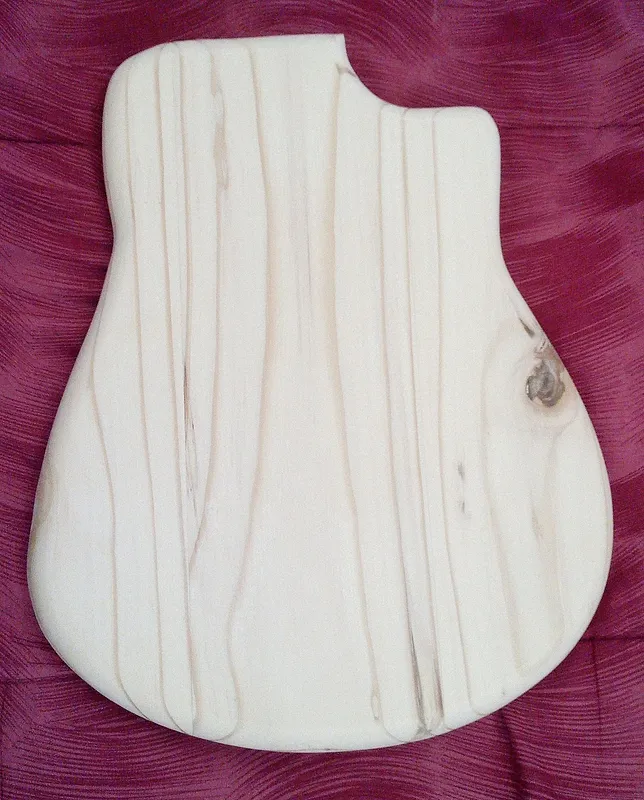

Guitar Cutting board
Made using Pine, 6mm bit on cnc. Round over edges using router table. After sanding it to a smooth finish, it was oiled with food safe oil.

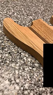

Hard Maple

just fyi, pine is not a good wood for a cutting board, serving tray maybe.
Billy McGee · February 16, 2021
Hi, yes this was one of my first templates out of Pine. After this I used Ceder wood that is much harder.
Andre Spilsbury · February 17, 2021
Andre, Pine and other softwoods like Cedar do not make good cutting boards as they allow food particulate to be forced into the wood the way they measure this is the janka test pine and cedar are between 350-650 while an appropriate wood species like Maple for example is around 1450.
john metcalfPro · March 22, 2023
