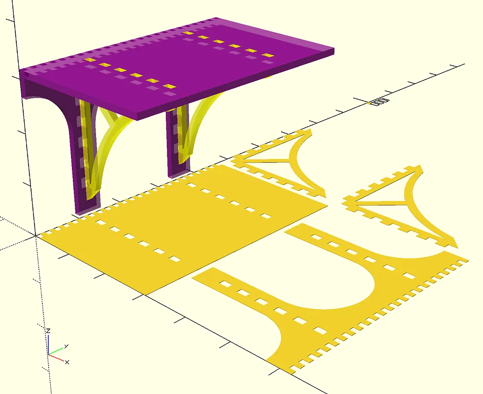

- Adjust settings in the scad file.
- Render with 3d() until desired settings found (you can render with both if you like as well).
- Comment out 3d() and render real with just cut_plan() and F6.
- Export the result as an SVG.

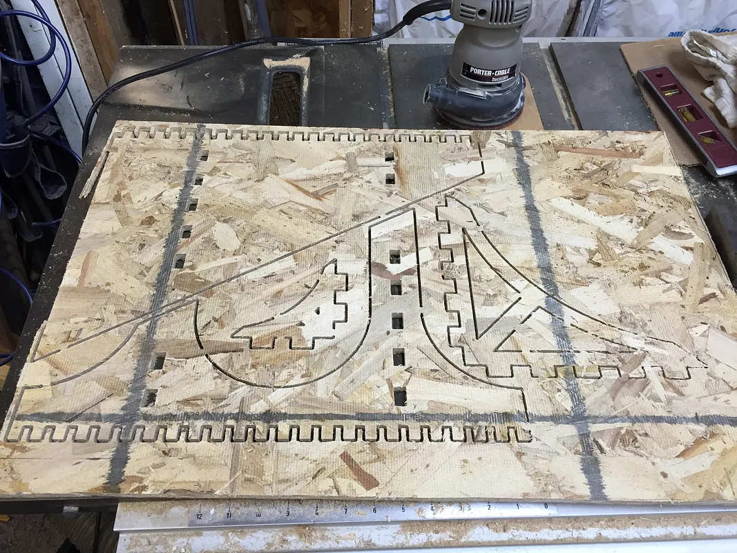

- Carve the thing!
11 Alternate. If you want to give it a try, you can run the Easel Dogbone generator plugin. It takes quite a bit of fiddling to get the correct result as the generator seems to play with both the scale of the object being dogboned, the location of the object, and the cut style. It would probably be a better idea to add dog-boning to the openscad itself...
Without dogboning you will have to either accept that the pieces won't fit together quite completely, or adjust for this post-cutting via sanding or other method. A smaller bit will reduce the gaps. You could also set the thickness a little larger than your actual material.
