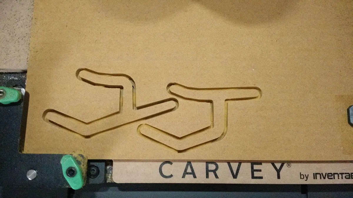

Mill profile shape
Use either double sided tape or small tabs to secure the hooks in place. Mill the design out of your choice of MDF or experiment with new materials.

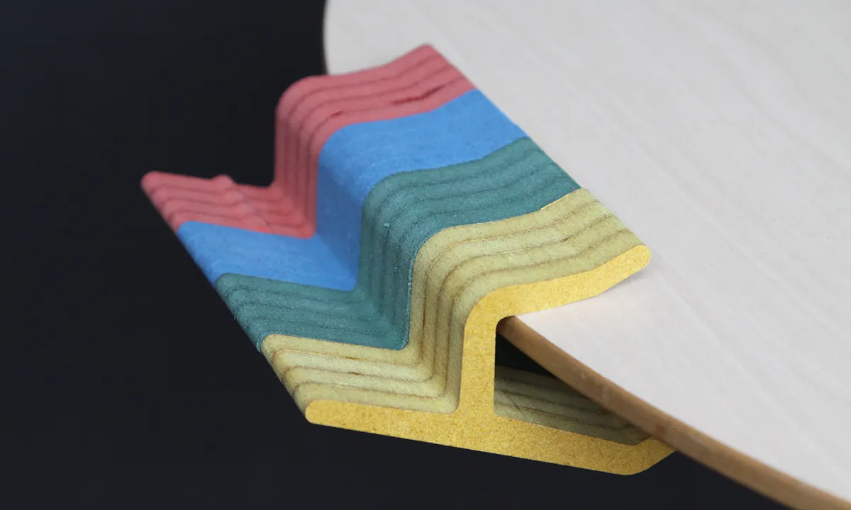

Glue parts together
Use either super glue or wood glue to adhere the parts together. Use small dots to avoid overflow. You can stack as many as needed. 4 parts wide works well for backpacks and bags, a 2 stack is great for keys
