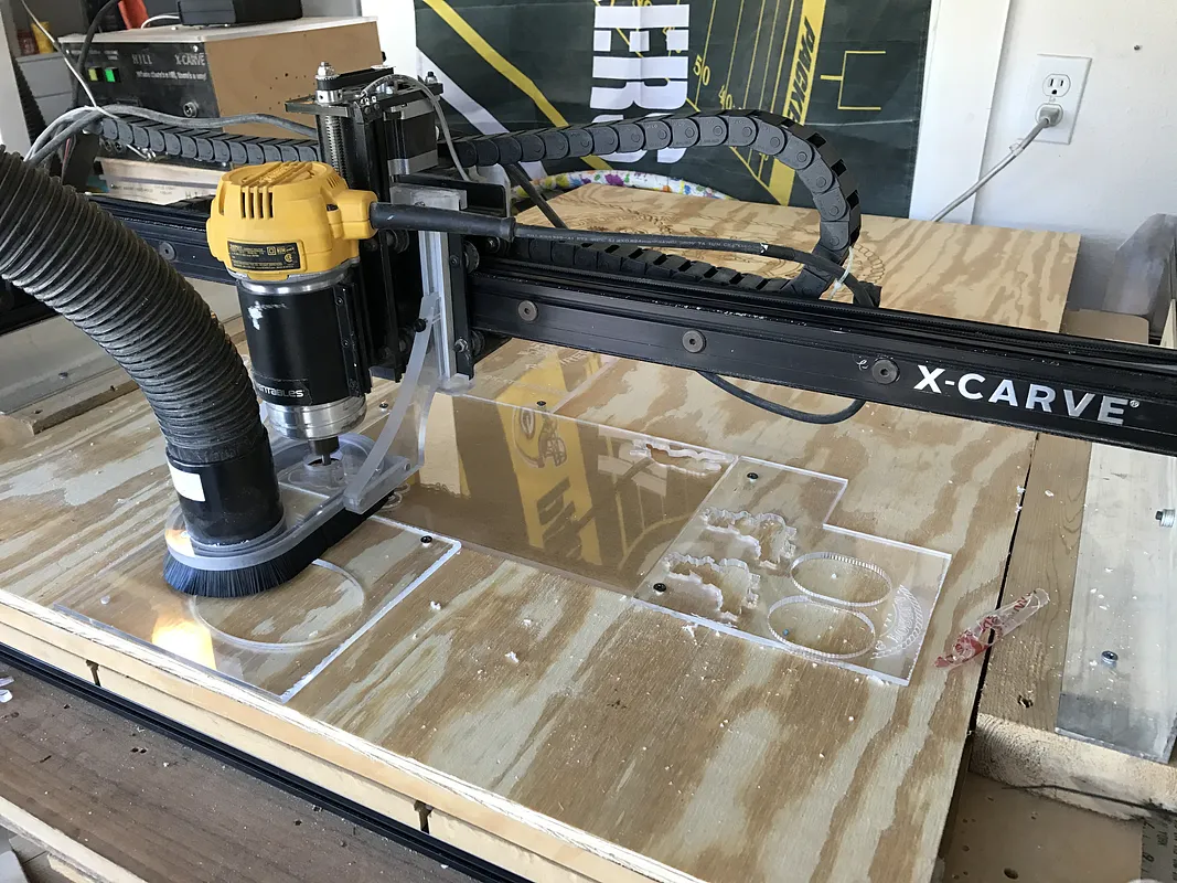

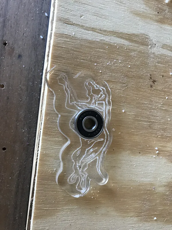

Greyhound Fidget Spinner cut in acrylic. I used a tapered bit but found some burs on the edges so may try to use a 1/16" bit or 1mm ball nose in follow-on attempts. I used a propane torch to clean up the burs and edges which came out pretty well overall.
