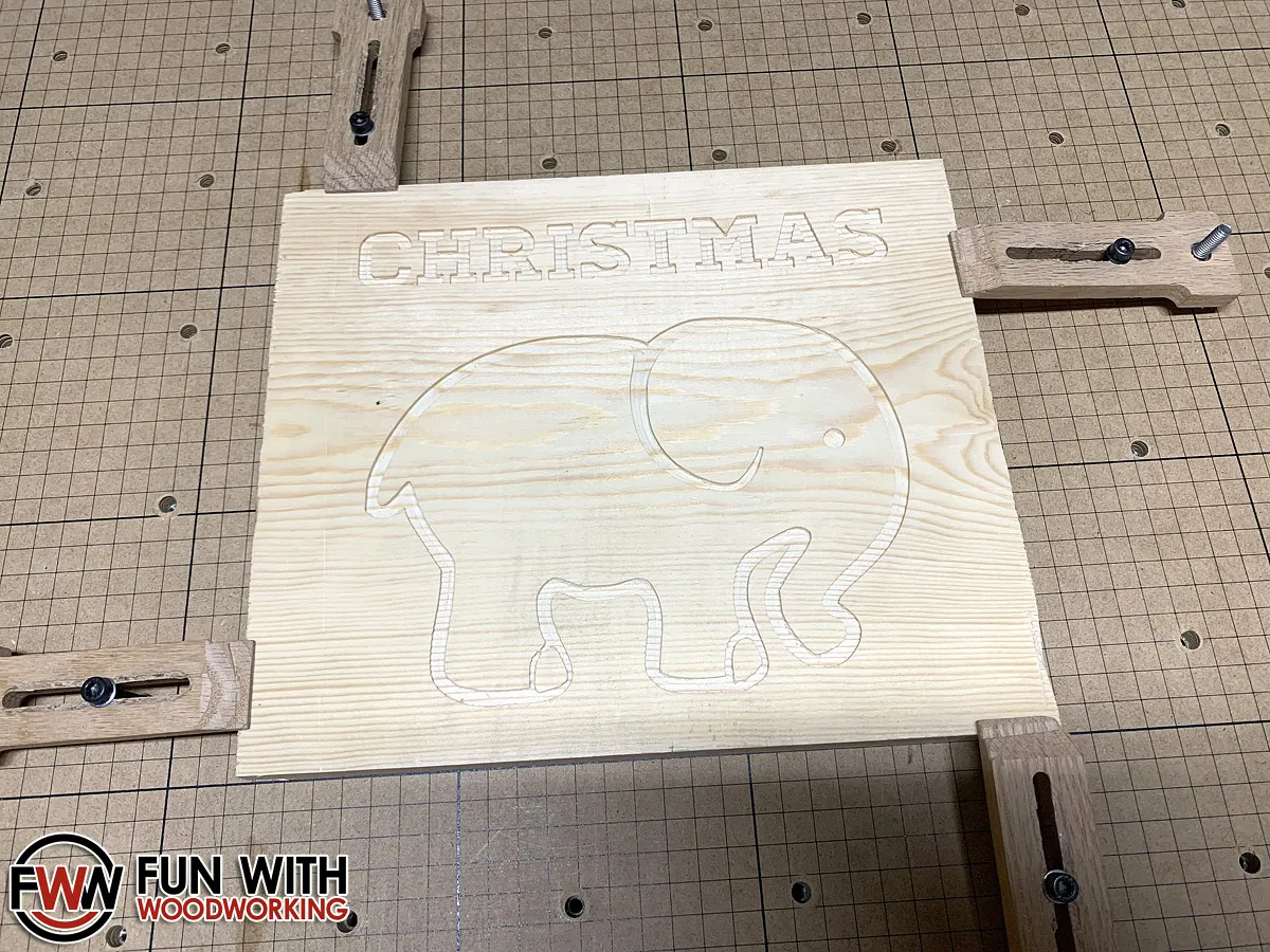

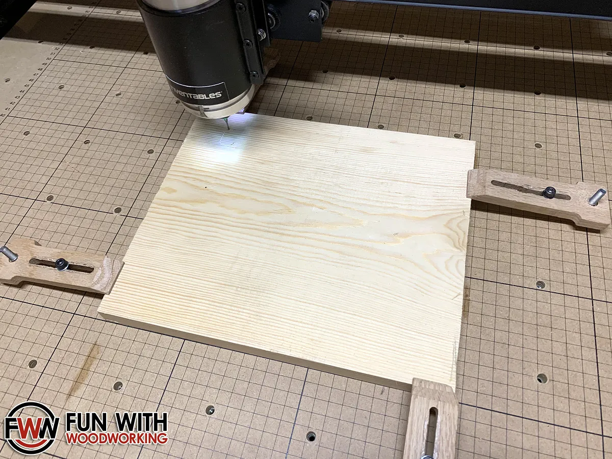

Open project in Easel and cut it out
Mount your board in your X-Carve. Open the project in Easel and size it to fit your board. Run the program and carve it out.
Estimated time: 30 minutes

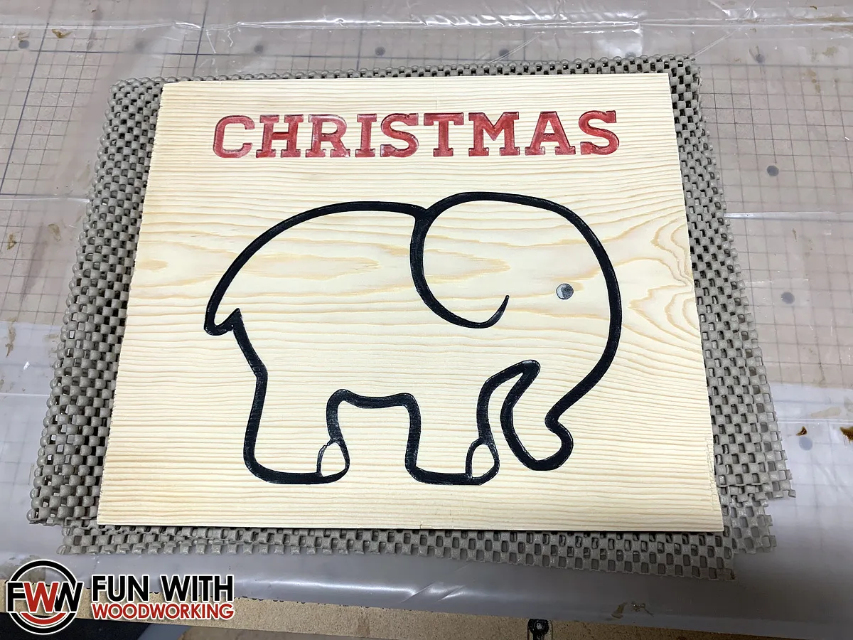

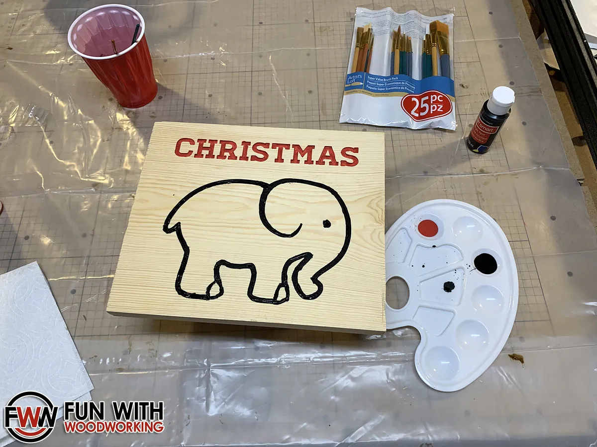

Paint the words and Elephant outline

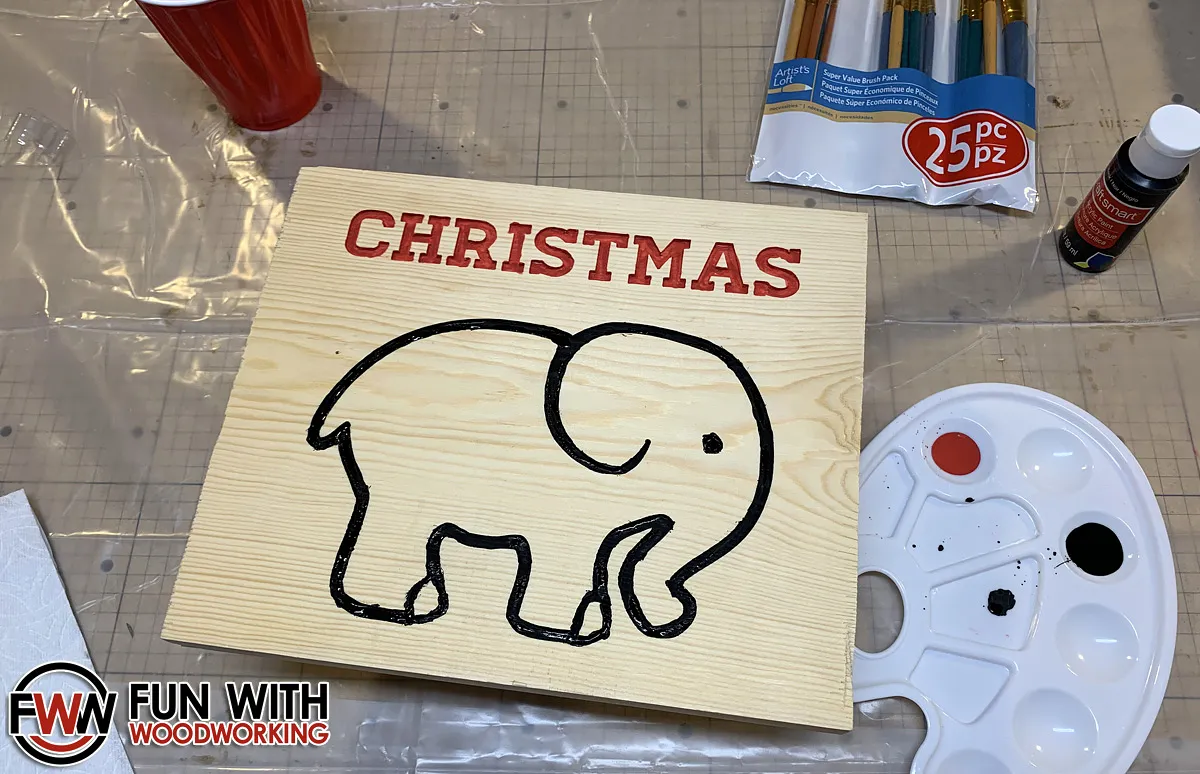

I was short on time so I hand painted mine with acrylic craft paint. I painted the word Christmas in red and the Elephant outline in black. I took my time and tried to keep as much paint off the outer surface as possible. I let the paint dry over night and through the next day.

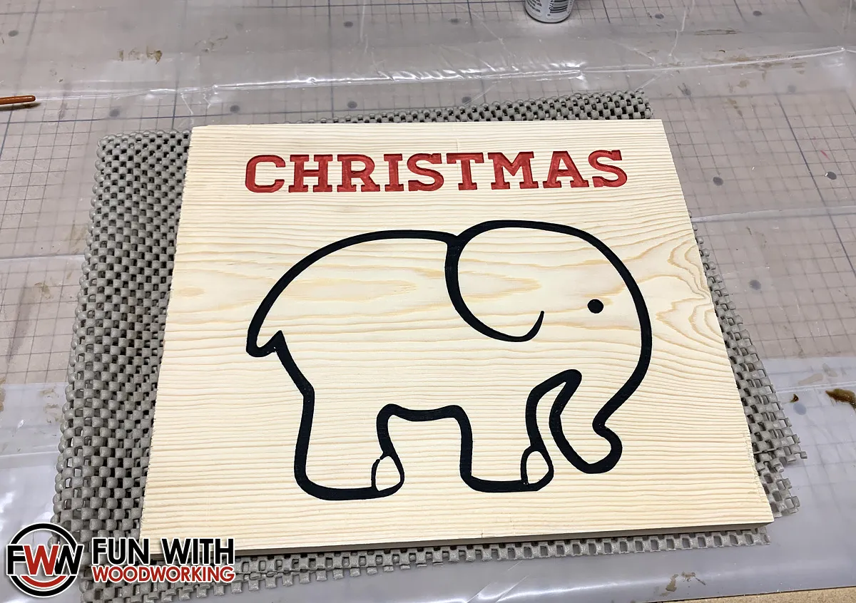

The next night I used my random orbit sander with 120 grit sandpaper and sanded off the excess paint. I used my shop vac to suck up all the sawdust in the carved out portion and then wiped it down with a dry cloth.

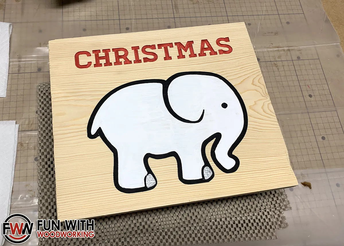

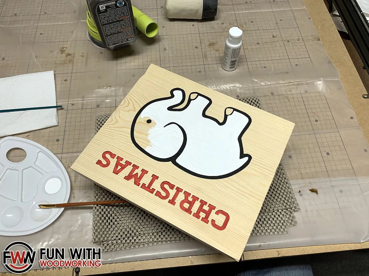

Paint the Elephant
Once again, I used acrylic craft paint to color the elephant white and I used some metallic silver for his toenails. Why metallic silver do you ask? Because it's my elephant and that was the color that I chose. You may paint your elephant's toenails whatever color you choose but do not come crying to me when you realize that my elephant's toenails look better than yours.
