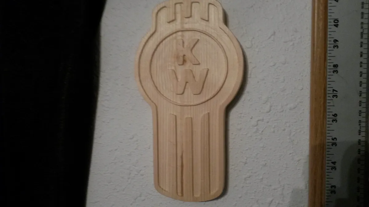

Setup and Carve
open in easel and make sure all your settings are correct
Easel setup:
When you open this in easel please make sure and check all your settings as mine may not work for you
Saftey Height: .150" Step over: 40% Feedrate: 45 in/min Depth of cut per pass: .0625" Depth of total cut letters: .110" Depth of total cut Outside: .748" material thickness: .748" Material type: Pine Wood Bit Size: .125" Bit Type: solid carbide 2 Flute straight flat end mill
Make sure and use tabs to hold the project in place as it is being cut
Also make sure that the letters are carved before the actual piece is cut out
make sure and give yourself enough stock so that you can clamp the project down with out crashing the machine or you can use double sided tape
I hope you enjoy this simple project if you have any questions just let me know
This is cool, is there a way to take out that kw and add a business name, I will download it and give it a try.
