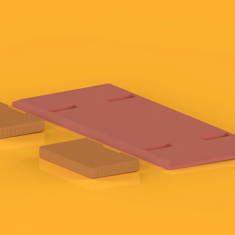

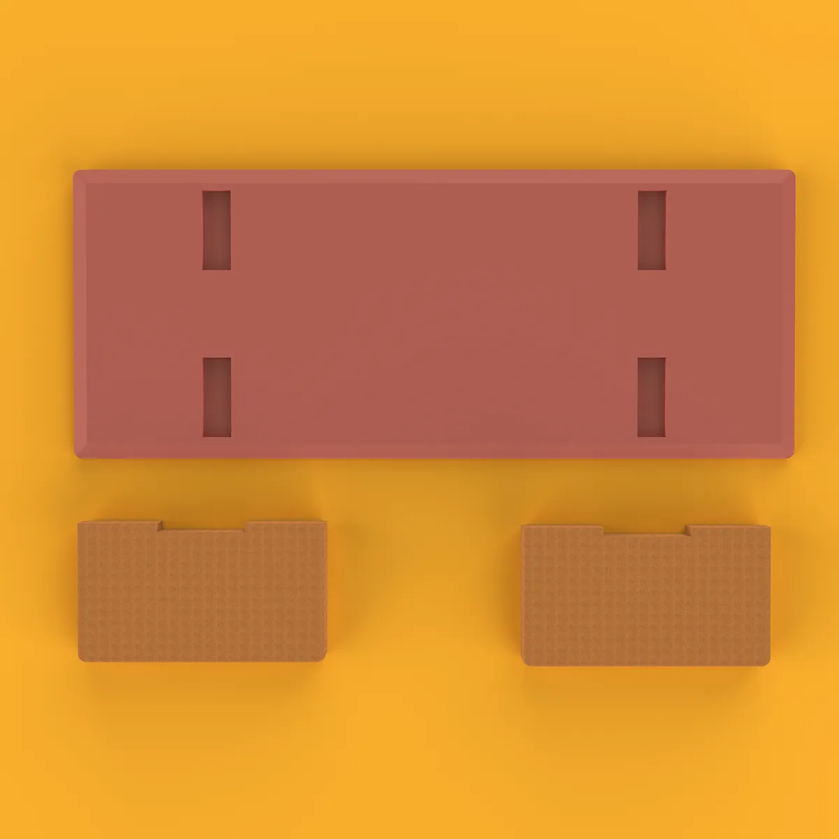

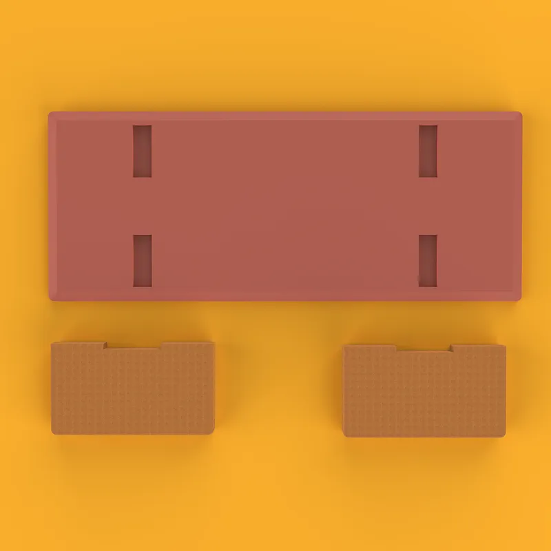

Before we start carving we first have to glue de 2 mdf pieces together over night.
We will begin by cutting the top part of the stand: Start by securing the glued piece of mdf to the X-Carve using a couple of screws. The piece of wood has to have at least 300mm x 500mm x 12mm. The first carve will be using a 90° 1/4in (6mm) V-bit to create a chamfer on the piece. On the rest of the pocketing and cutting programmes a 1/8in (3mm) double flute bit is used.
Stand Legs: For the Legs secure the plywood piece piece with 300mm x 500mm x 12mm and carve using the 1/8in(3mm) double flute bit.

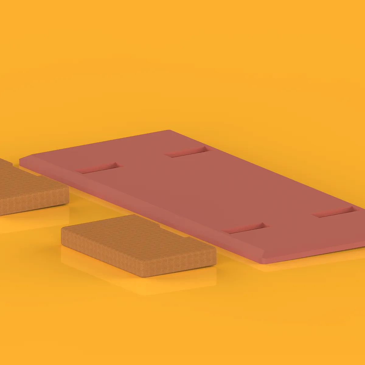

Sanding and glueing
After finishing cutting your pieces give it a good sanding and glue the leg pairs in a sandwich using some wood clamps so they are 24mm thick.
As soon as the legs have dried you can glue the top part with the legs using some wood glue and clamps.
