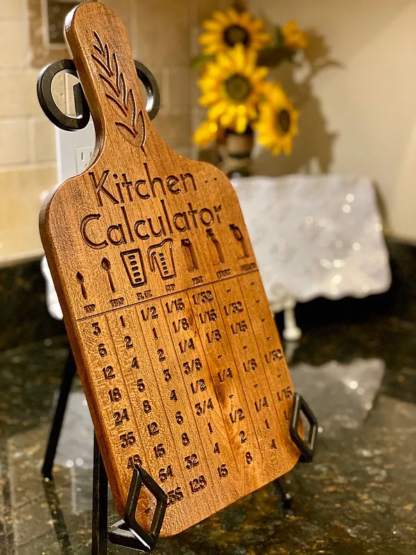

An easy carve of a Kitchen measuring conversion Chart. Carved out of 1/2" Cherry, using 1/8" bit, 30 degree v-carve and 1/8" for the perimeter. The Drill point at the bottom left use to ensure all multiple carves start at the same location (x=.25, Y = .25). Wife and friends love this item.

Looks Great! How are you getting the contrast between the engraving and the face of the board?
Heather MerloPro · February 05, 2022
It’s the natural contrast from the wood. Being that the face is sanded down to 400 grit yet the engraving isn’t sanded at all. I have found that cherry shows more of the contrast, however they all have once a spray finish or oil is applied. Glad you liked it!
Shannon DolesePro · February 07, 2022
How deep are you making the cuts in this board
Tracy ThurmanPro · April 16, 2022
If I am not mistaken I did it at at 1/16” depth
Shannon DolesePro · April 16, 2022
I will check and reply if different then stated. Also it should show in the file
are you using the 1/8 bit first and then going back over with the 30 degree v-bit

Answering This is a very nice project. I'm not sure how the guide holes work when you flip the piece over to carve the back. Do you flip the wood vertically of horizontally? I have a jig that I carved the board to sit in this ensuring it’s in the exact position for zero back and front carving
Shannon DolesePro · September 16, 2022

I just did you Kitchen Calculator it looks beautiful ! I did mine it came out awful, I used the 60° Bit on all.
John Dixon · October 11, 2024
If I am correct, I used a 30 degree bit for the carving due to the small size of the lettering. I believe that a 60 degree bit is too wide for the small lettering and the depth of the cut What type of wood did you use?
Shannon DolesePro · October 12, 2024
Just pine, i just saw my post it looks confusing it should of said I did yours and came out awful.
John Dixon · October 12, 2024
