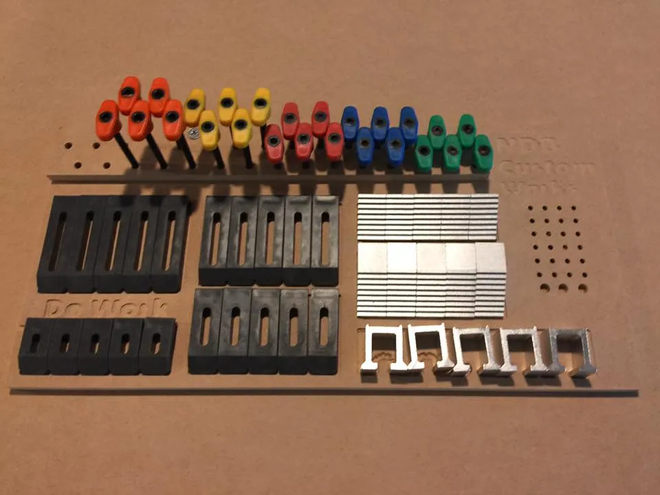

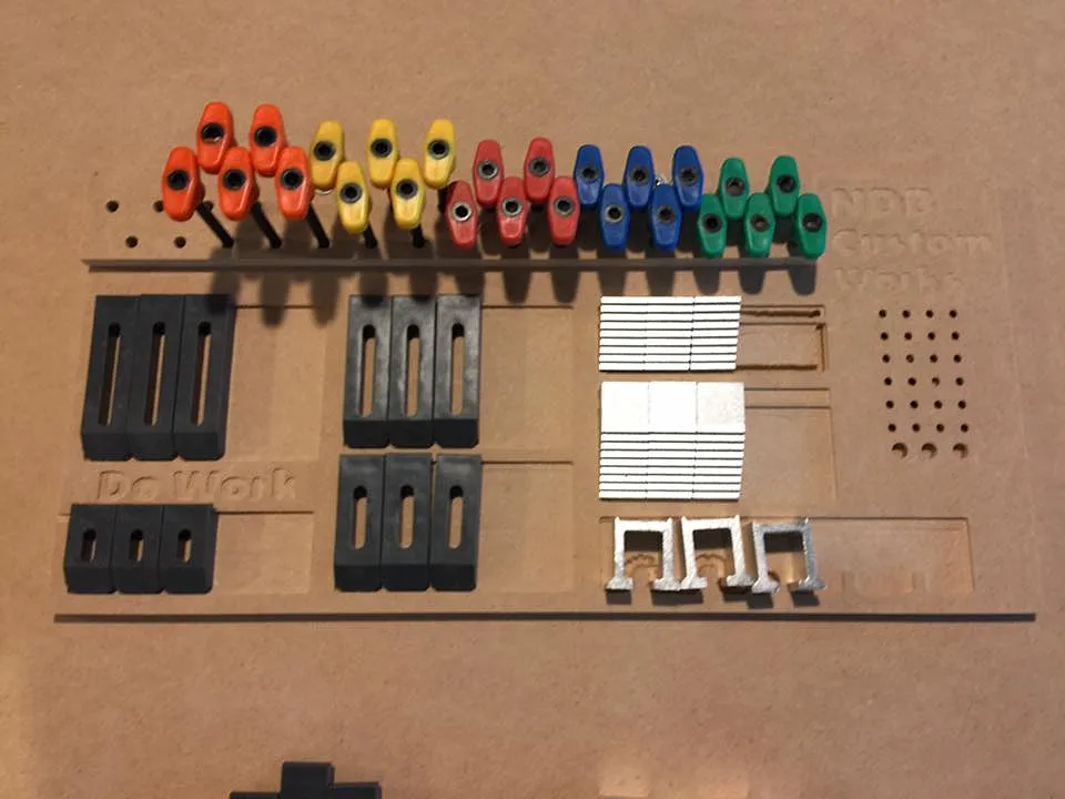

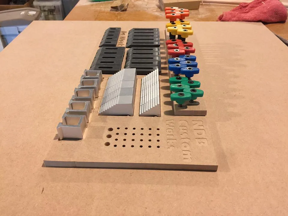

For X-carve clamp set. Small pocket holes on right hold the 1/16, 1/8, and 1/4in router bits if you want to have them all visible. Top piece is cut out and glued overlapping the matching holes on the tray giving more depth to stand up the clamp screws. Squares are 3mm deep to create a small edge.
MDF
I just made this, thank you. Had a little issue with my material thickness and messed up the top piece but overall i like the design thank you.
