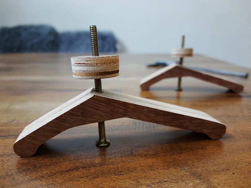

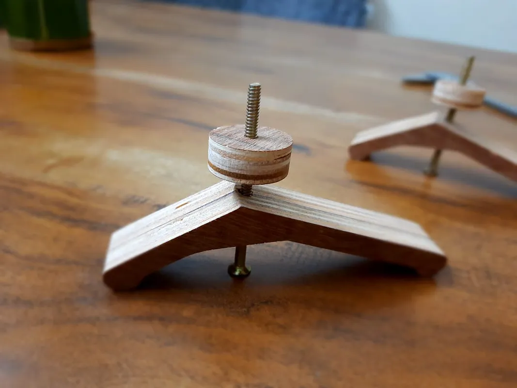

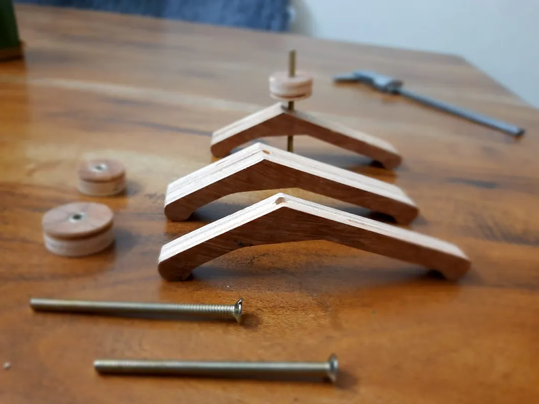

Quick clamp with knob. Use 1/8 Inch - 3.175 straight cut router bit. Total time : 7 mnt Depth : 3 mm Feed rate: 2000 Stock height : 12 mm

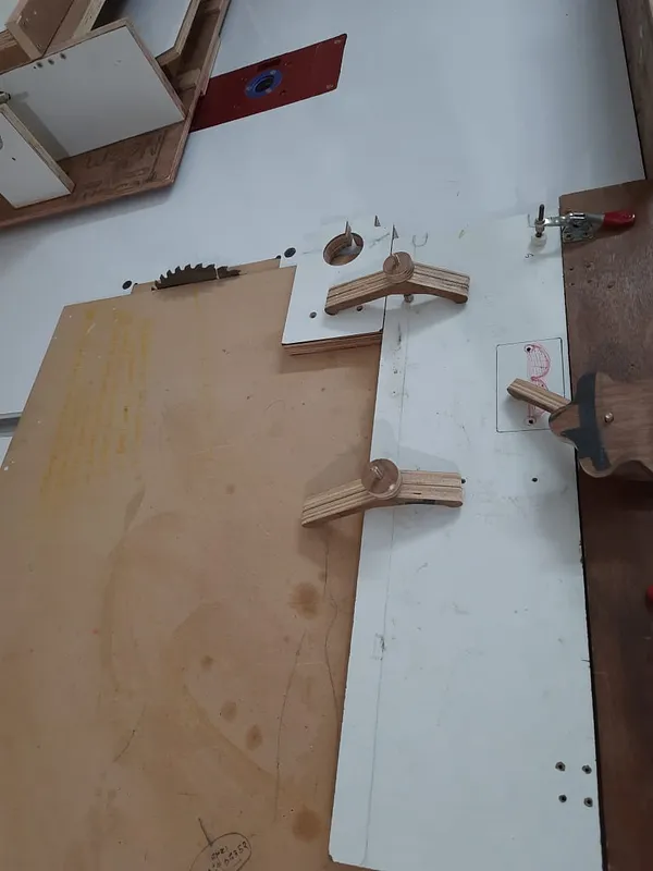

Practically i use it to clamp for my cross cut sled with fix the bolt with epoxy.
