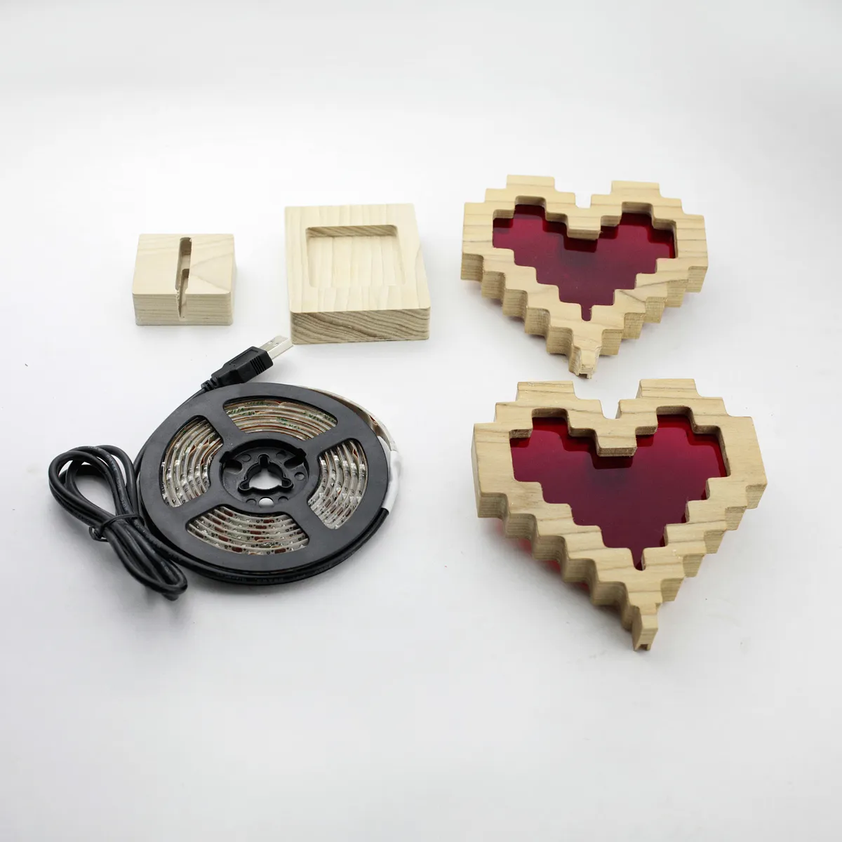

Saw off the tabs off of all work pieces and begin sanding down the edges. The acrylic pieces will not fit into the recessed channels for them without some sanding - check the fitment after every few passes to make sure you end up with a nice, tight fitment. If your fitment is tight enough, you should not need any adhesive. But it couldn't hurt.

The most difficult part of the process is securing your LED strip. Start with the side of the strip that meets the cable. Remove the adhesive backing then place the cable inside the channel at the bottom of the heart. Move around the inside of the heart, pressing the LED strip against the edge, being careful to make as much surface contact as possible. You may need to add a small bit of glue underneath the strip if the strip is not sticking firmly. You don't want the it to fall out of place, because we're about to glue everything up.
Assemble!
Making sure that your cable is coming through the channel at the bottom of the heart, glue up the heart with wood glue and clamp. Once dried, make a 90 degree bend in the cable at the base of the heart, pointing it backwards out the back of the channel. Add a small bit of wood glue to the base of the heart and then press it firmly into the channel in the upper piece of the stand. Attach to the lower piece of the stand.
