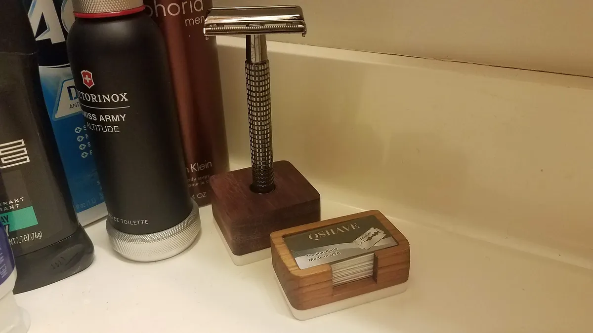

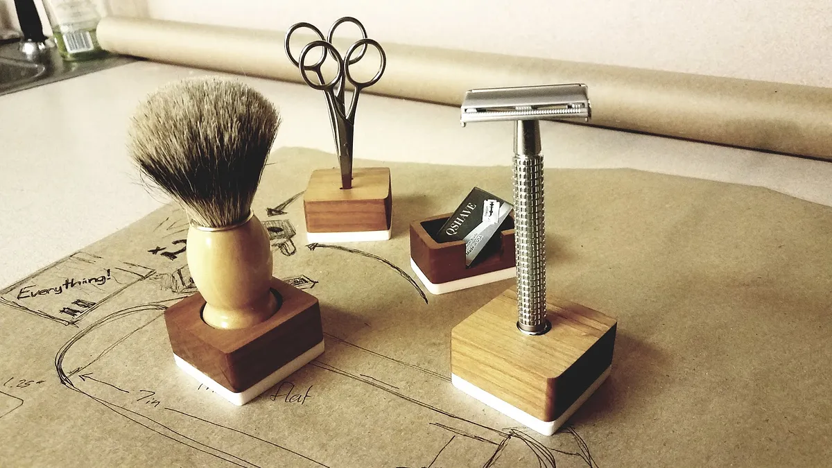

I designed these sets as part of Christmas gifts for my family. After failing terribly as some ambitious integrated designs, I decided to keep it simple. I'm pretty happy with how (most of) these turned out. If you like these and want to make them, go for it! If you plan to sell these, please credit me in all of your product descriptions by linking to this project page. That's all I ask! This kit consists of:
Razor Stand Brush Stand Scissors Stand Razor Holder

Carve the corian pieces using the 1/8" straight bit. This is pretty straightforward.... I used tabs on this, but do whatever you're most comfortable with.
Estimated time: 10 minutes
Carve Wood Pieces
Still using the 1/8" straight bit, cut the wood pieces. The job will carve and cut everything except for the scissor slots, since they are too small. I used beefy tabs here since you're doing some pretty aggressive cutting/carving. After carving leave the material mounted to the wasteboard, swap the 1/8" bit for the 1/16" upcut bit. Select everything except for the two slots for the scissors, and set the cut depth to zero. You only want to cut the two scissor slots with the 1/16" bit.
Estimated time: 50 minutes
Assemble & Finish
Using a little CA glue, glue the corian bases to the wood pieces. Let the glue setup. This only takes a few minutes. I didn't clamp anything, but if your material is a little rough or not flat, you could do that I guess.
After the pieces are glued together, use a disc sander to sand the walls so that they are flush and smooth. You also might need the disc sander to touch-up the radiused corners.
After all that I just used some 320 grit sandpaper to smooth everything out and finished with mineral oil and beeswax.
