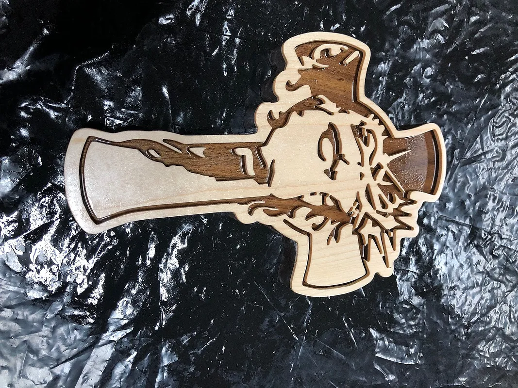

Copy of Jesus_Cross layered with 3/4" Dark Walnut and 1/8" Hard Maple. Carved deep enough through the maple to allow the Walnut to show as the background. Also added outside with optional stand layout

What size cnc machine did you use and how did you carve the top of the cross? Did you use a 3018 like your project very much

Xcarve 1000. Don’t understand the question about how the top was cut.

However, I glued a piece of 1/8" maple to 3/4" walnut for contrast and set the top cut to slightly deeper than the maple to clear to the walnut. Using purpleheart is also nice contrast.
