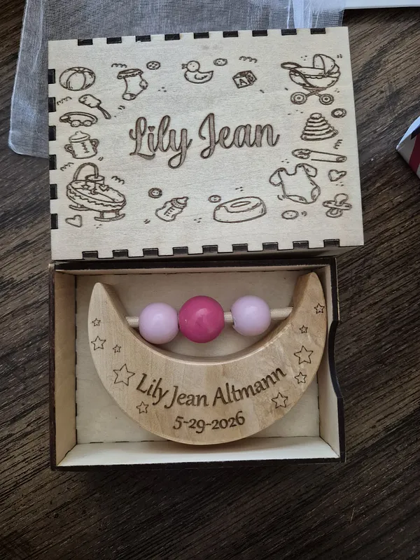

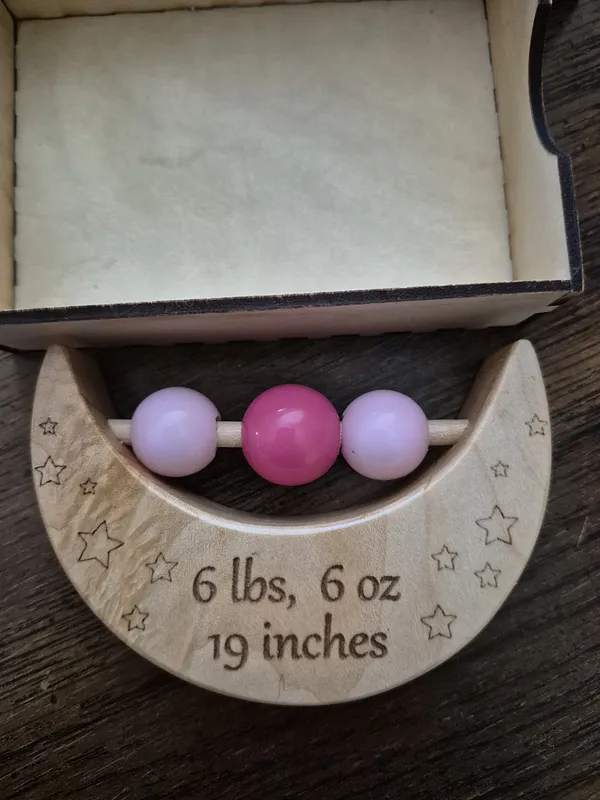

shape cut out with a 1/8-inch straight bit out of 3/4-inch-thick maple. I drill a hole through the ends to insert a 3/16-inch dowel. For the rattle I but 22mm and 16mm acrylic beads. I have to drill a larger hole in them to fit the dowel loosely. I use a laser to engrave the name on the front and the weight and length on the back. If I have time I make a presentation box as shown in the pictures
