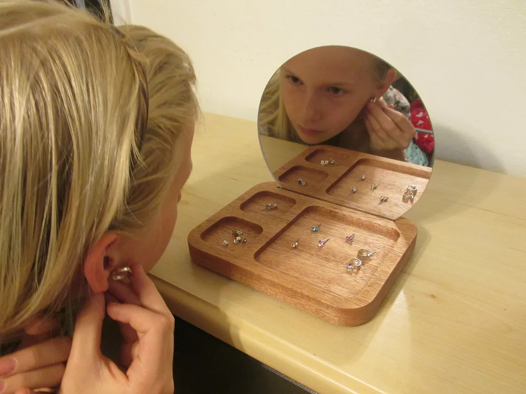

Good News: The Easel project contains all the necessary drawings for the magnetic jewelry holder project.
Bad News: Since only one Easel project can be linked as the primary file, the Easel project only has one material, while the magnetic jewelry holder consists of three different materials.
There are multiple ways of attacking this, but here is what I suggest: 1. Make 3 copies of the project file, for a total of 4 Easel files, and name them "TOP", "BOTTOM", "COVER", and "ACRYLIC". 2. In each copy, erase everything that isn't specific to that part and position the remaining items as a group at 0,0. 3. Erase the text in each copy, since it is only there for identification purposes.
There are notes specific to each cut profile in the step to perform it. Read those notes carefully, since material thicknesses may change.

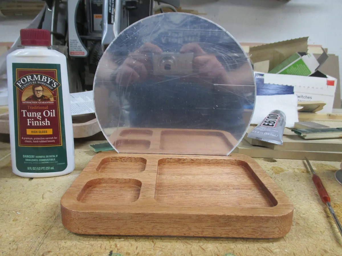

Cut Top Profile and Project Outline
Clamp down the main wood stock (in my case, mahogany) and load the "TOP" profile in Easel. Either use tabs, double-sided tape, or some other method to ensure the piece doesn't move around during the final pass of the outline cut.
Be sure to offset the cut file as needed to avoid hitting clamps with the outline cut.
I cut out the pockets using the two stage cut program, using a 1/4" 2 flute upcut flat endmill as the roughing bit and a 1/8" 4 flute upcut flat endmill as the detail bit.
These are the settings I used for my Dewalt 611: Roughing: 1/4" 2 flute upcut flat endmill: Dewalt setting '1', .100" depth of cut, 60 IPM feed rate Detail: 1/8" 4 flute upcut flat endmill: Dewalt setting '2.5', .030" depth of cut, 60 IPM feed rate
Be sure the detail bit is sticking out farther than the thickness of the material, and that collet nut will not hit the clamps at full cut depth.
One good way to get a clean bottom in a pocket is to do a cleanup cut that is about .005-.010". This may require you to adjust your cut depths a little bit. A final cleanup pass adds time, but it's time you can use with a refreshing drink in your hand instead of sandpaper.
Profile Notes: -Material I used was .765" thick. You want about .090" of wood between the magnets and the jewelry, any thinner and you may end up tearing through the pocket when you cut the magnet holes. -Based on the material thickness, and the thickness of the magnets and lauan plywood, these pockets are .275" deep.
Estimated time: 60 minutes

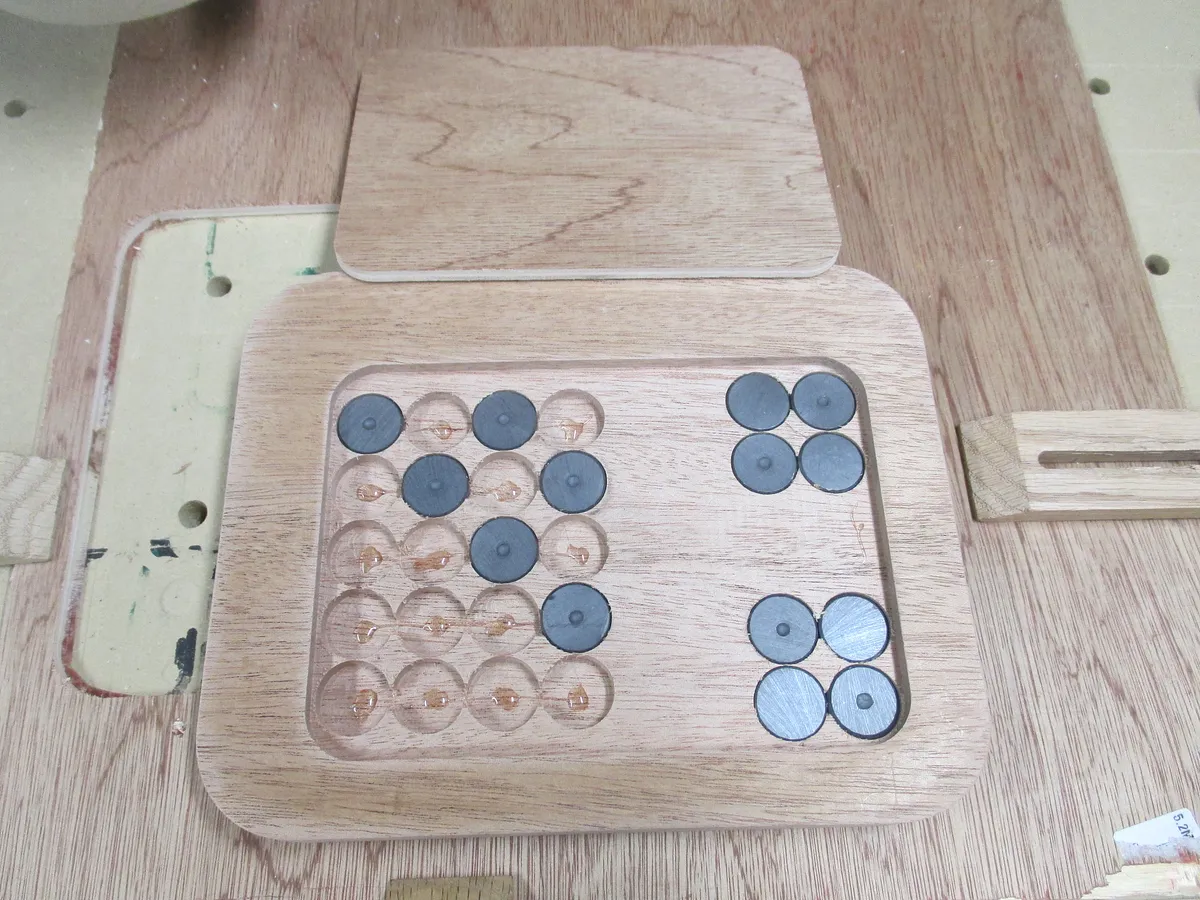

Epoxy Magnets into Bottom
Remove dust and loose fibers that are in the magnet pockets.
Use small dabs of thick epoxy to hold the magnets in place. You can use a thin glue, like super glue, but it may soak through the pores and become visible on the inside of the top pockets.
The magnets I chose have the north poles marked on them. The magnets will need to be installed with magnets in a north-south-north-south position. This way, they will be attracted to each other and will stay in place while the epoxy cures. Don't fight the magnetic field if you don't have to!

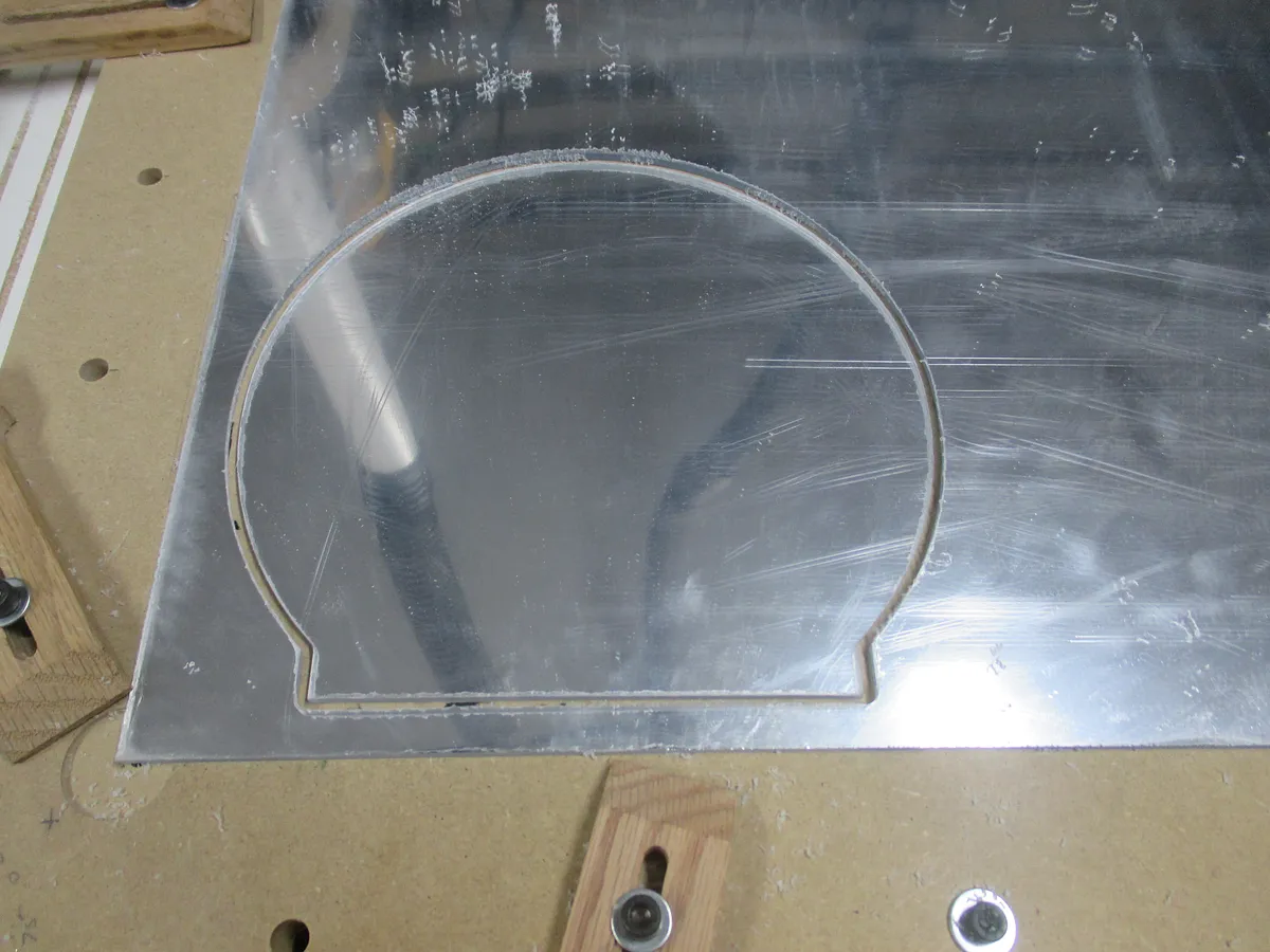

Cut Acrylic Mirror
Clamp down the acrylic mirror and load the "COVER" profile in Easel. Either use tabs, double-sided tape, or some other method to ensure the piece doesn't move around during the final pass of the outline cut.
If you choose to use double-sided tape, test it on a small piece of the acrylic mirror first to make sure it doesn't peel the reflective backing.
I used double-sided carpet tape to hold the acrylic mirror down, and clamps to secure the edges.
These are the settings I used for my Dewalt 611: -1/8" 4 flute upcut flat endmill: Dewalt setting '1', .020" depth of cut, 50 IPM feed rate
Profile Notes: -Material I used was .112" thick.

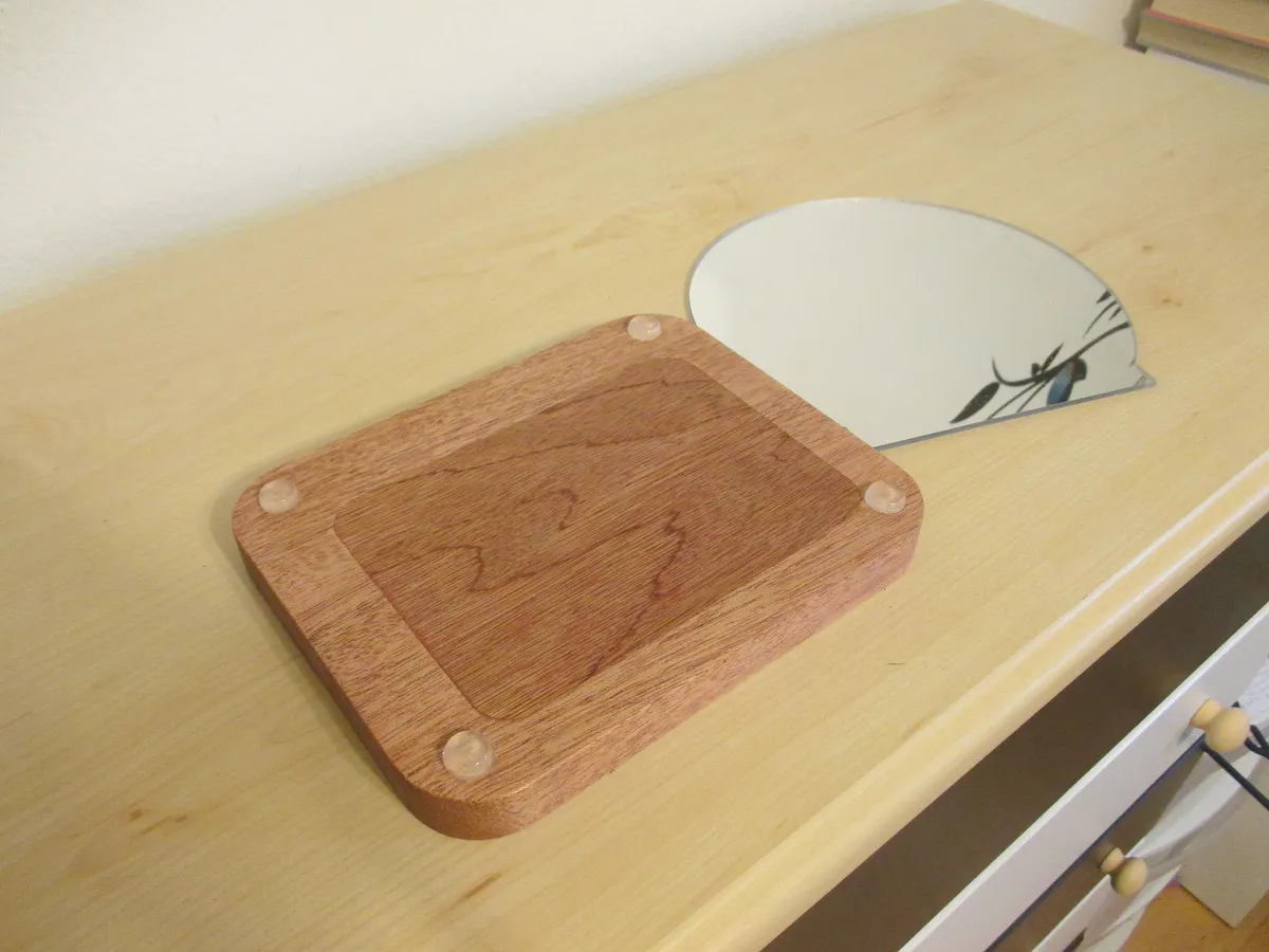

After the finish has been applied and is cured, apply little rubber feet to the bottom of the project to keep from scratching up any nice furniture that the project is placed on.

Love this! I would like to make this but can't for the life of me find the TOP profiles that actually hold the jewelry. All I can see is the pocket and holes for the magnets. Can anyone help me out?
