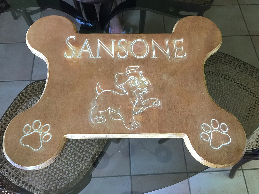

Protection for the wall to avoid scratching it from the dog 1st pass: straight cutting tools with tabs for retention 2nd pass: contour same shape of first pass but with V bit 60° 3rd pass: sign and shape v bit 60° the plywood isn't a good choice but this is a try best job is a solid wood panel
x-carve 2016
Birch Plywood, Hard Maple
