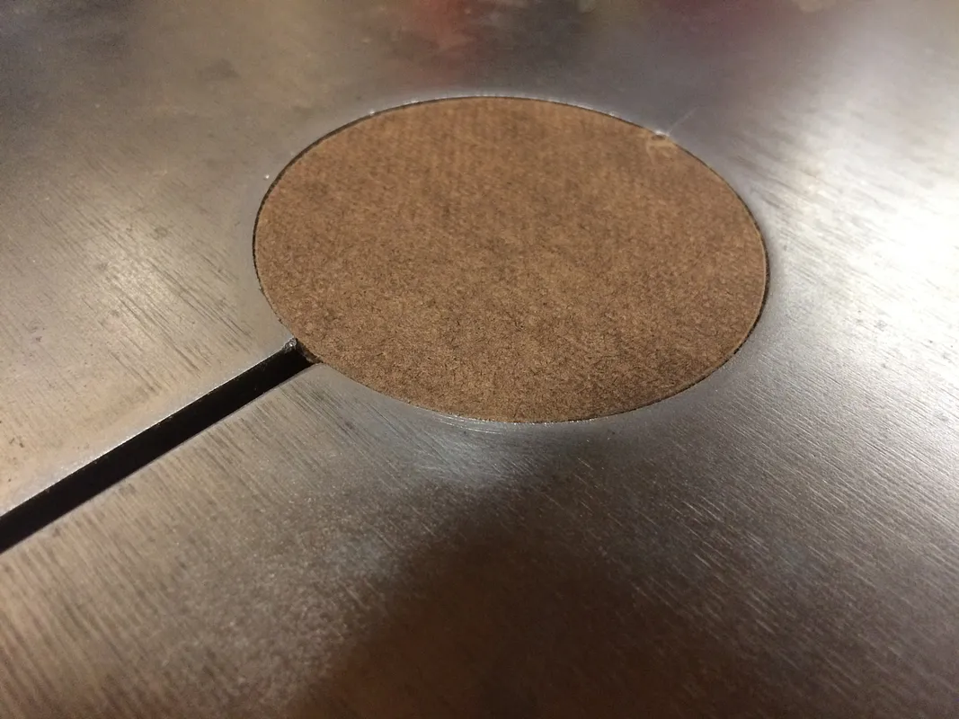

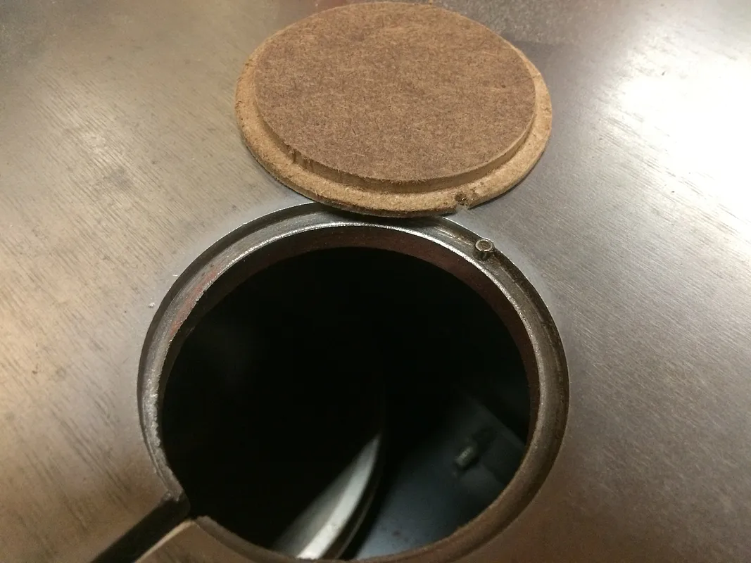

Super simple zero clearance inserts for most 14" bandsaws. Made from 1/4" hardboard (masonite), these work out to only a few cents per piece.
The material was .22" and the step down from the table was .1". As a result, the cut needed to be at .12" to leave that .1". Yours may be different.
