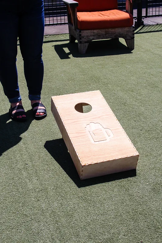

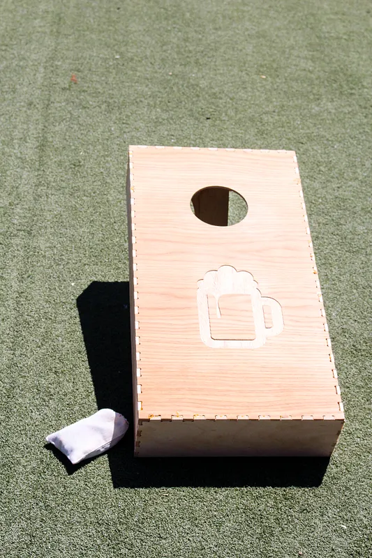

Each workpiece needs to be cut twice (4 sheets total). This project was designed to fit on 4 18" x 24" sheets of 1/4" material.

You can add a custom design to the different boards. I added icons from Easel.

Assembly the boards
Use wood glue and clamps to create the boxes. You can add a hinge to the feet so they can fold and over and stack up when stored away.
