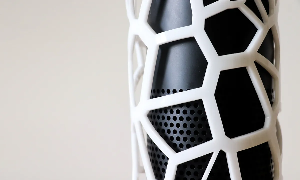

-Mold (I used a PVC pipe from Home Depot 3.5 diameter - the Amazon Alexa has a Diameter of 3.3 inches so feel free to change the fit) -Felt - Melted acrylic is impressionable -Gloves - protect those finger tips -Cooking Sheet -Aluminum Foil -Your Oven (just like when you make cookies!)

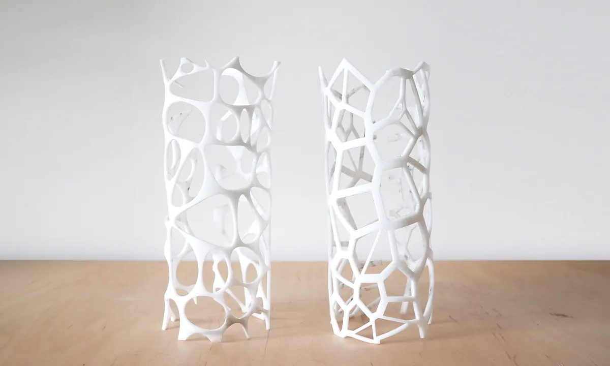

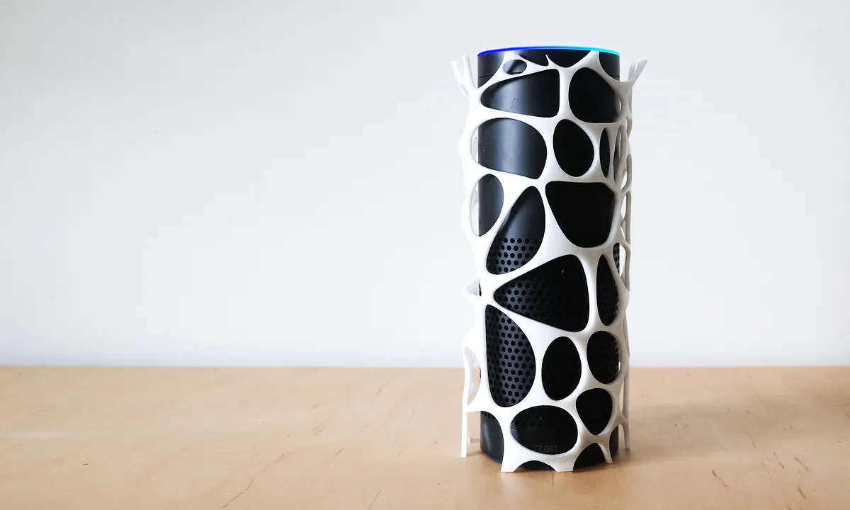

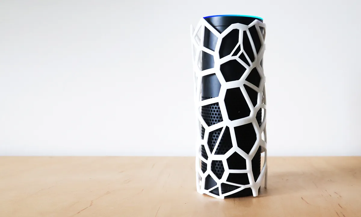

- Download the given template from Digital Files. I have uploaded two different types of Voronoi files - an Angular and a Circular version. Feel free to use which ever one speaks to your soul.
Or if you’re feeling spicy, you can create your own Voronoi Files. Just download the Voronoi Sketch Generator AutoDesk Fusion 360 add-in and create your own unique pattern. "Click Here":https://apps.autodesk.com/FUSION/en/Detail/Index?id=1006119760063675415&appLang=en&os=Mac
The dimensions should be roughly 9.25 in X 11.5 in depending on what fit you want and what mold you are using. Then export your file as a .dxf. You can than take this into Photoshop or whatever file editing software you like.

Take it out of the oven and slide it from the aluminum foil onto the felt. Now quickly wrap around your mold.
This will all happen very quickly. Make sure to hold it in place for several moments until the mold has hardened.
