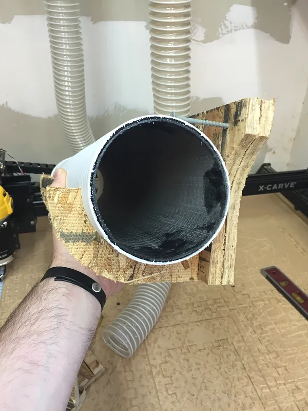

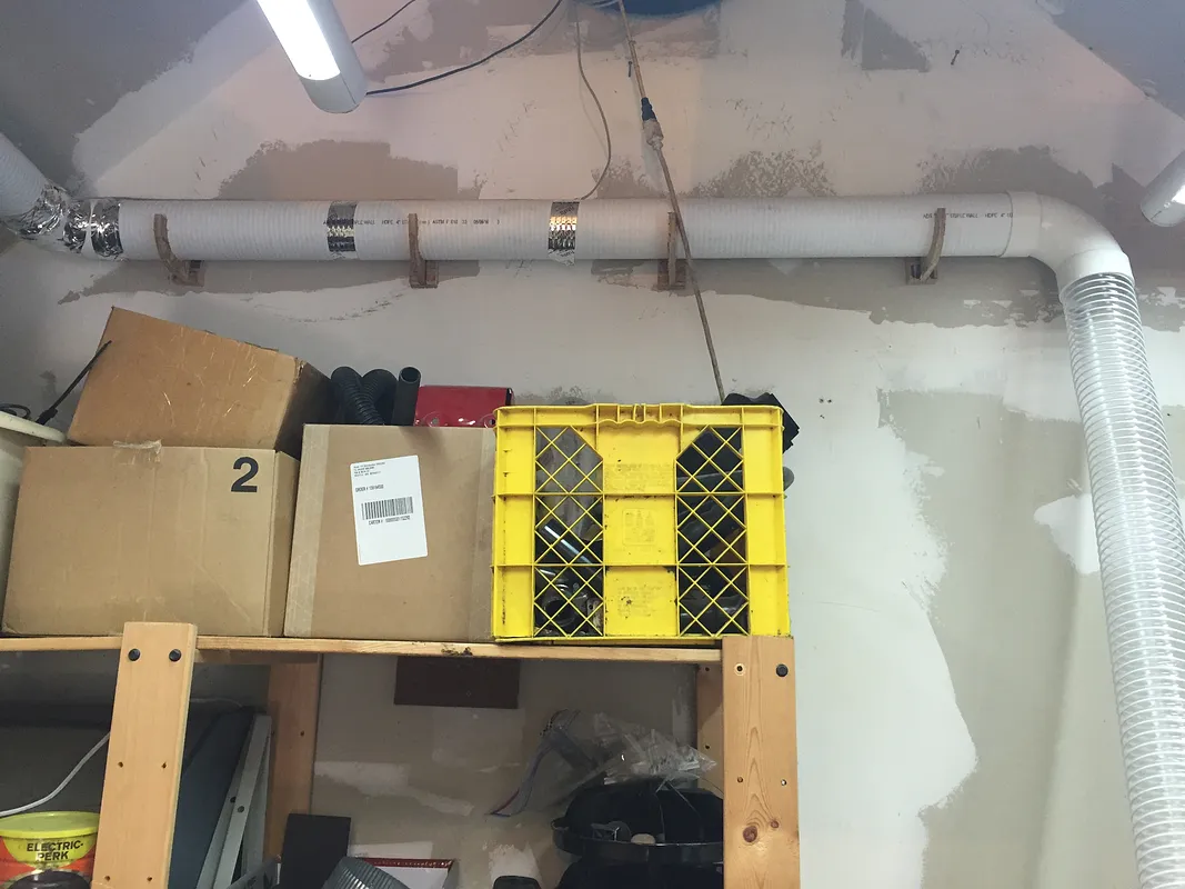

These hooks are shaped to support common 4" drainage/vacuum pipe. Cut in nominal 1/2" stock. The two wall pieces fit around the hook to anchor it without glue. the clearance above the pipe is tight, so a long screwdriver bit is helpful.

Made a few of these last night. I did have to slow down the cut speed cause the OSB was flimsy and breaking the tabs, so it did mess up my first attempt. Regardless, Design is flawless and fits together great! Thanks for sharing!!!
