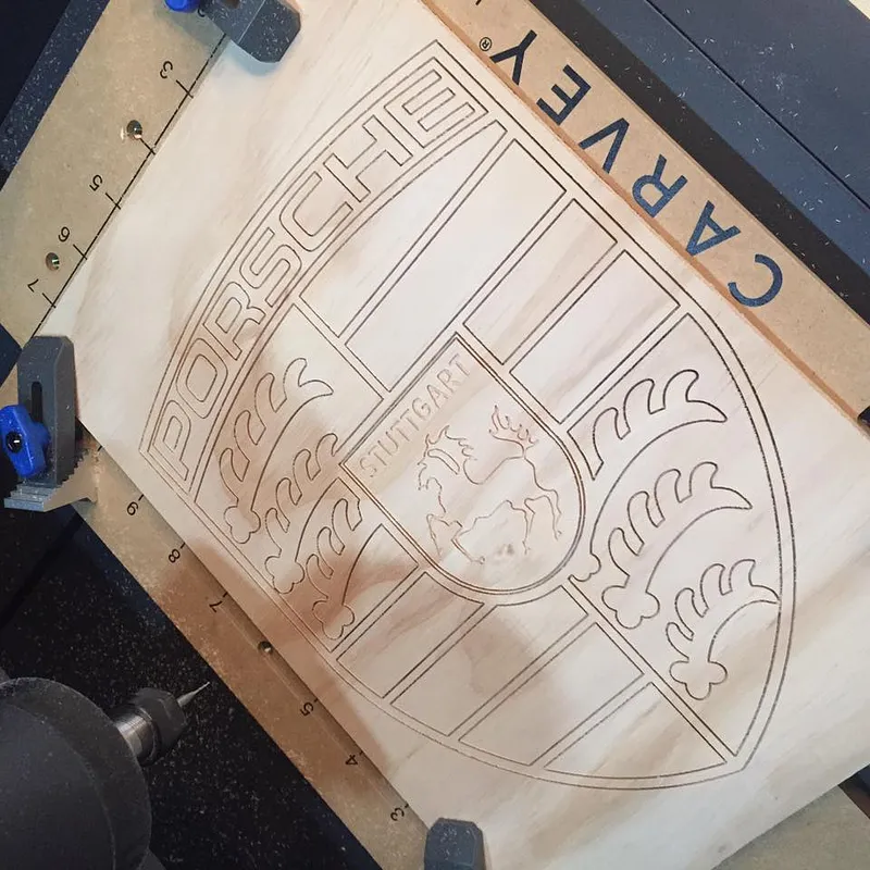

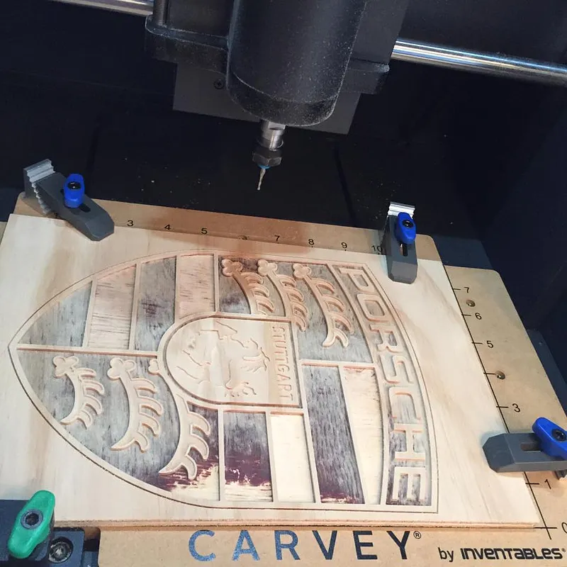

Project done in several steps:
1. Fine details - Lettering and horse (1/32" 2FL fishtail)
2. Pockets with details (1/16" 2FL fishtail)
3. Simple pockets and cutout (1/8" 2FL Straight End)
Total cutting time 1h 40 min. (Still trying out controls and settings to speed up the process)

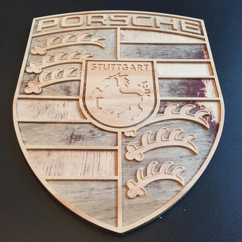

Be aware that currently (22.04.2016) a bug in Easel is creating an error in the toolpath just over the STUTT. I will post a comment when I notice the bug is gone.
A quickfix for this is to place a white rectangle on top of the problem area. It will make the toolpath right.
The problem has now been fixed... Aparently is was a combination of a complex svg-file and the level of detail in the preview and how the toolpath was generated. I have uploaded a new svg for download and the project is updated.
Be aware that currently (22.04.2016) a bug in Easel is creating an error in the toolpath just over the STUTT. I will post a comment when I notice the bug is gone. A quickfix for this is to place a white rectangle on top of the problem area. It will make the toolpath right.
Thomas Broen · April 22, 2016
Thomas Broen · April 23, 2016
